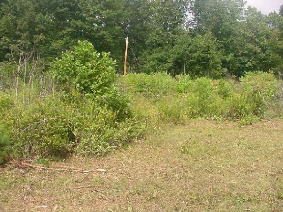

I run a 5' Land Pride cutter through some pretty thick brush. I've only 16 HP @ the PTO.
Now, I run in 1st or 2nd Low, but it works pretty good for me.
Land Priide recommends 20 PTO HP for this size cutter.
The pic shows the stuff I was cutting.

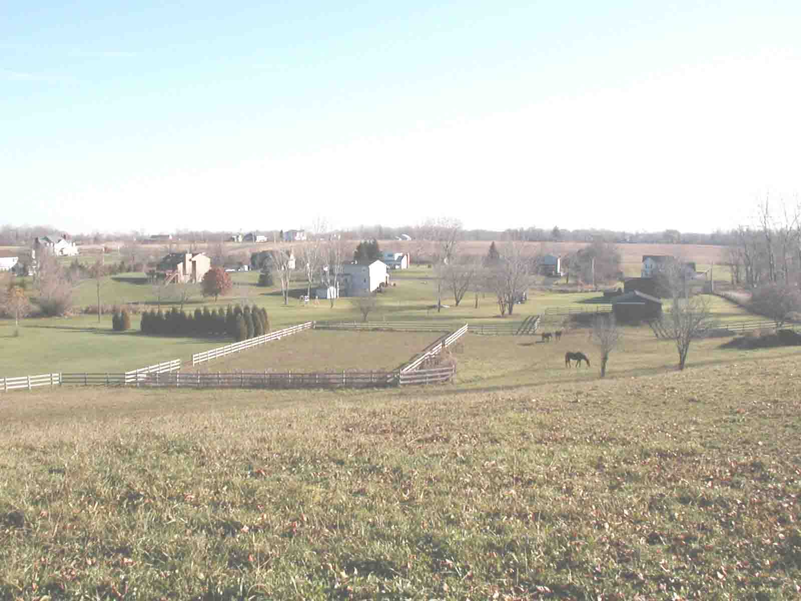

timb,
I run a JD503 (5') rotary cutter behind my JD755 with no problems. I have a pasture that goes uphill (see attached photo). I mow up and down the hill including cross slope. I have cut brush higher than the hood of the tractor and taken down stands of large saplings and bushes. If I couldn't push it over with the tractor I would back into it. The 755 did the job. Certainly I had to go a little slower in the real heavy stuff but I got the job done. I typically cut the pasture once a month and the 755 moves right through it.
The 755 is 20 HP (15 at the PTO), 1700 pounds plus another 300 for the mid mount mower which is usually attached.
The 503 cutter weighs 500 pounds. About 80 to 100 pounds of front ballast weight is helpful when the cutter is in the raised position.

   / Smallest Deere - 5 foot rotary mower #10
Another photo looking from the top of the hill with NO SNOW /forums/images/graemlins/grin.gif
