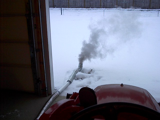

After the last time the smoke lingered around in the garage, I figured why not try this. Works great. Gerard

What is that you're using, Gerald?

Gerald that's a good idea. Years ago we used to use a similar crushproof tube for service stations that my family owned. There were also small openings on the bottom of the bay doors (gun ports) that you could pass the tube out of while the doors remained closed to the cold. They worked quite nicely even back then. This is the company that we used to purchase them from. exhaust system

I do this too on days when there isn't enough wind to blow the smoke out the door fast
enough or I'm taking off the back hoe and I have to run the tractor while I'm in the garage for a few minutes.
I used radiator hose and a small copper pipe connector. Works great.

Hey Gerard,
Do you have any varmints? I've used this approach with the exhaust pumped into their holes.

Great idea. I'm going to rig up something similar. If i don't open all the doors my smoke alarms go nuts.
I wonder if a short pipe connecting the exhaust to the air intake would work. noooooo. /forums/images/graemlins/laugh.gif
   / Smoke "outside" #8
Re: Smoke \"outside\"
Isn't that called a "turbo charger"? /forums/images/graemlins/tongue.gif /forums/images/graemlins/grin.gif

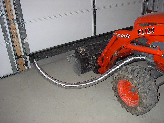

Roy: It's 3" flex hose with rigid vent pipe on the end. Here's a side photo of it taken the night before the snow fell. Gerard

PineRidge: Thanks for the link.
When the KIOTI has a permanent parking spot (addition needed) I will put a dryer vent in the wall. Right now it's parked where the Corvette usually is. Gerard
