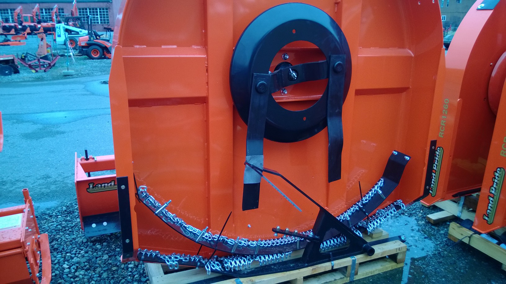

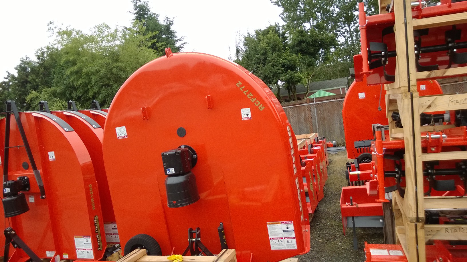

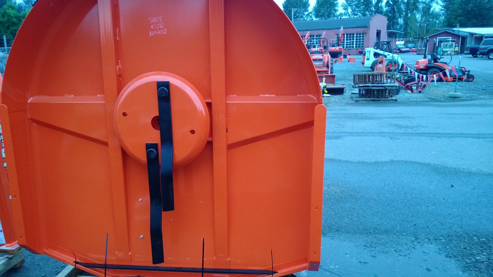

While at the dealer today finalizing some details on some simple mods to my new l5460 I wandered around looking at stuff.
Man, these mowers look freaking huge stood up. I seriously did not want to knock one over looking at it. The pic doesn't show it, but these are monoliths...
Thought pics might be interesting to some as they show differences in blades, stump jumper, etc
Med duty smooth top (the dealer only stocks smooth in med duty).
Bottom med duty
Bottom light duty

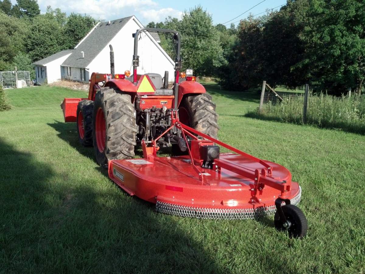

The leaf blower cleans the crap of the top of my BH27 in seconds my buddies old king kutter was difficult because it was not flat. Besides water draining and easy cleaning they are just more aesthetically appealing. I believe the BH20 medium duty series stump jumper is more solid like the lower picture.

Yeah, middle picture the LP 27, lower the 20 (both 72).
In comparing directly, the med duty (27) is alot more mower although a lot more money too. I might not buy one till spring, but at this point leaning towards the med duty (rcf2772)
The dealer doesn't stock the heavy duty one. Man that HD one must be heavy, the med duty one is over 1000lbs in the 72 inch.

thanks sorry i should have said mine is a bush hog bh27 which is 7' / 84" model
My other choice would have been the land pride 2784 both models were built really well and rated at 3" capacity
The BH was about $250 cheaper than the landpride and it saved me another 110 mile round trip out to rosy brothers to get the land pride, after i was told they had one in stock only to arrive and find they didn't have a single medium duty 7' in stock of any model or brand. 2 hours wasted so i went with my local dealer flint new holland for the Bush hog
