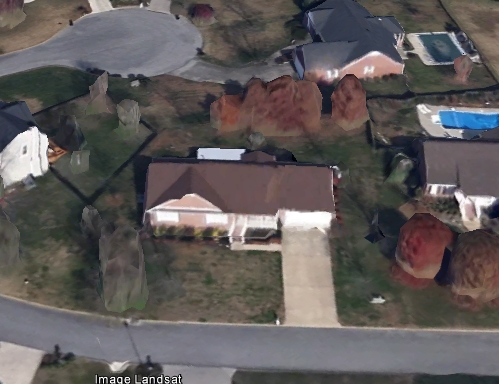

Here is a Google earth shot of the yard. back just goes to trees
