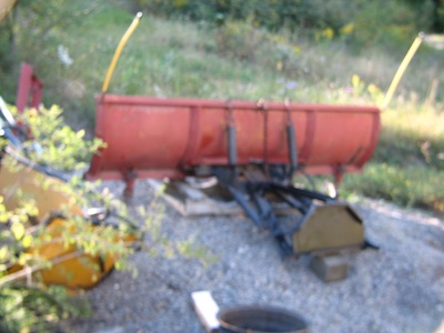

There seem to be a multitude of used spring tripped plows for sale that come off trucks etc.(Curtis, Western and others). As long as you find one with working hydraulics and the right width, I wouldn't think it would take too much to modify the mounting arrangement to work with a PT plate. And probably for a lot less than laying down 2K+ for a new Curtis loader plow. Shorten down the existing frame attachment assembly to get the plow as close as possible to the PT and add an attachment plate with some bracing.

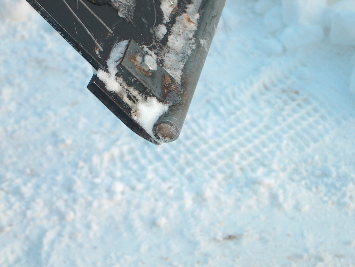

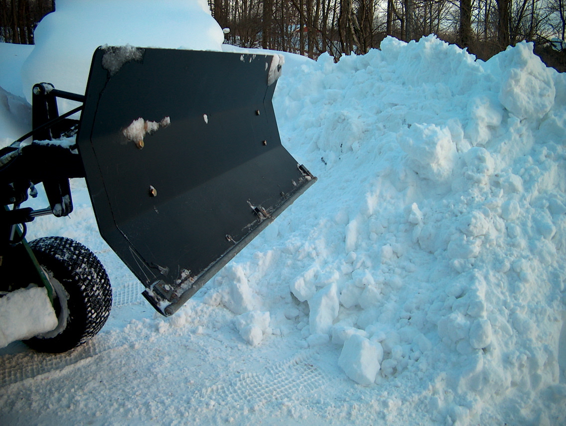

I have a stock pt425 with Turf tires and find moving snow quite easy. I live in the great Tug Hill region of NY--and as you have likely heard--we have had a bit of snow over the past week or so.(87.1 inches) I have the snow/dozer blade with the steel cutter edge-- Instead of the bogie wheels on the plow I welded 3 ears to a 3/4 inch steel pipe that is bolted to the cutter plate holes ( one each end and in the middle) The pipe is the full length of the blade. The round edge rides over all irregularities and does not dig up the lawn if you are careful. The 4 in one bucket is also helpfull in moving the piles--and creating new paths where I had not been before. The pt425 is much more maneuverable than my F-150 and plow gets the job done quicker than the truck and never got stuck . Quite satisfied I made the purchase.
   / Snow blade options #9
Can you get a picture of the skids?
PJ
   / Snow blade options #10
Not sure these images will work.
Next time will use 1 inch or bigger pipe for better radius--that's all I had-- but it works.
Basic process is to set all parts with clamps and duct tape-- tack weld ears to pipe--remove and final weld--put back on blade--mark holes--remove and drill holes--- install--and go
