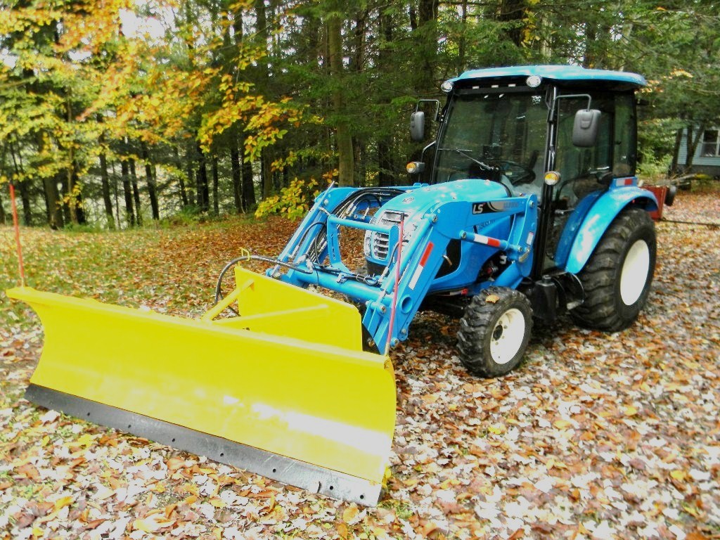

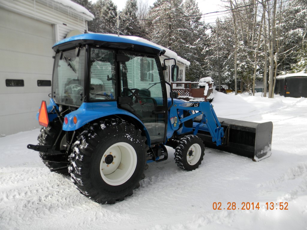

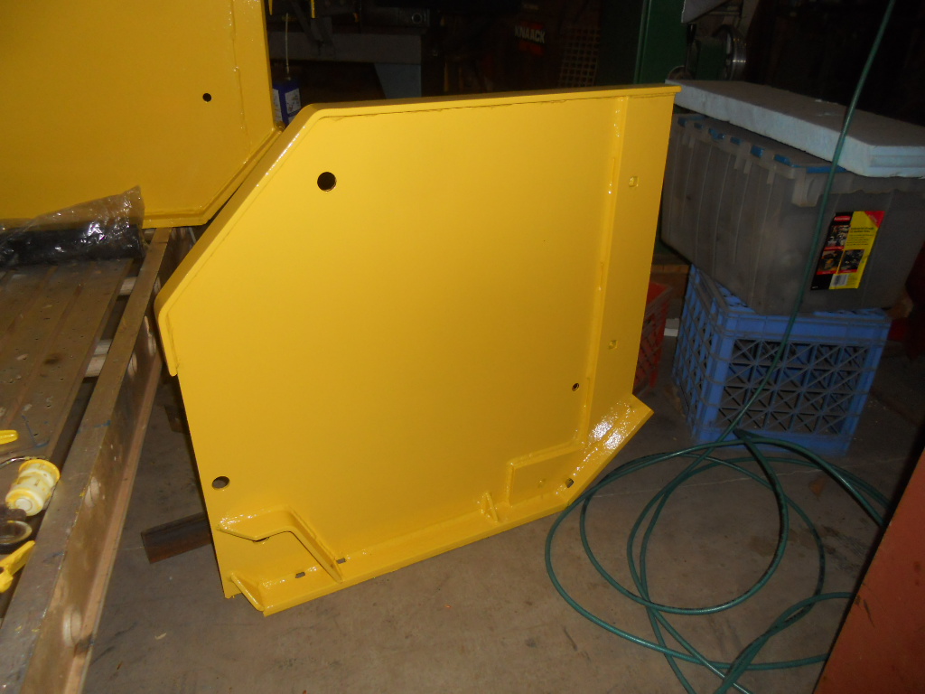

   / snow blade vs snow pusher #6
I agree with the others. I have both a 7'6" PA plow blade I use for the driveways I plow and a 7'6" pusher blade for straight runs on parking lots. My pusher blade has an adjustable height steel cutting edge. The pusher does create less stress on the tractor because its usually straight forward pushing. An angled blade does put side stress against the loader arms but nothing the tractor can't handle.

   / snow blade vs snow pusher #7
George, did you ever confront a situation or snow amount that bogged down the tractor with the pusher?
   / snow blade vs snow pusher #8
Not yet. When I first bought the tractor and pusher last Feb I didn't have chains for the tractor. Pushing snow across a lot or driveway it quickly filled the pusher and with no chains, unloaded tires, and no rear ballast the tractor would stop moving and the tires were spinning. Since the pic was taken I have loaded the tires, added chains, and rear ballast and have no more tire spin and no bogging down. We've had light snow storms but haven't had a deep, heavy, wet snow storm that would test any strain on the tractor yet. I'm happy with this tractor being about 1500 lbs heavier and 11 more HP than my last.
