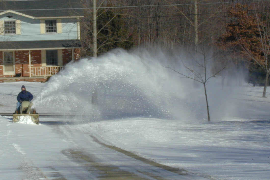

I bought a used Cub blower three years ago. It's the 45" 450 series intended for the last generation Cubs like the 1862 I owned.
The good news;
It throws the snow a mile.
With wheel weights and chains it will go through anything.
You have no piles/walls of snow left by repeated plowing of snows.
It removes snow fast, one pass.
It's fun to operate, OK, maybe that's just me!
The bad new;
They are expensive.
They are a bit tough to install, maybe easier on the 2000/3000 series.
You'll probably have one or two really wet snows in a seoson that they are ineffective on.
I bought a new 5252 this summer, when the dust clears that blower costs about $3000. I won't pay that but hope to eventually find one on EBAY or elsewhere. I still have the 450 for my trusty old 1872 so I'll probably buy a back blade for the 5252 as a backup.
One last thing, my driveway is 275 feet and concrete, I had to beef up the shoes for better wear. I don't know how well the blower would work on gravel.
Here's a picture of the blower in action...
Curt
