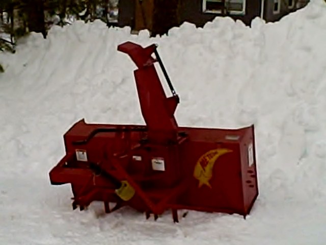

Just installed a B2784A kit on my B2620 with front blower B2781A. Easy installation and it would have taken but a few minutes except I didn't know that you have to push the FEL lever to the right "beyond" the detent position to turn the chute to the right. After switching hoses and basically taking everything apart again I went to the dealer and talked to their prep guy who asked if I knew that the lever had to go beyond the detent position... never knew that! Wonder what else there is about the tractor I don't know? Anyway, thanked him for helping out this old guy and now everything is fine.....just thought I would pass this along in case anyone else was thinking about adding a hydro chute rotator......it works great!

Thanks for the tip, Sandy.
For now, I'm stayin low-tech. I just say, "Turn the crank, Frank."

Same thing happened with me; I called the salesman and he "enlightened" me. Gotta love quick fixes!
