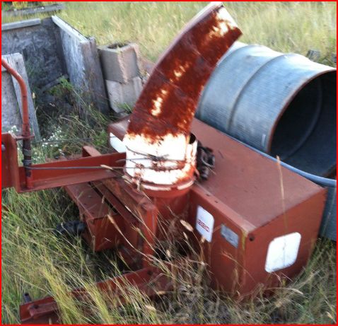

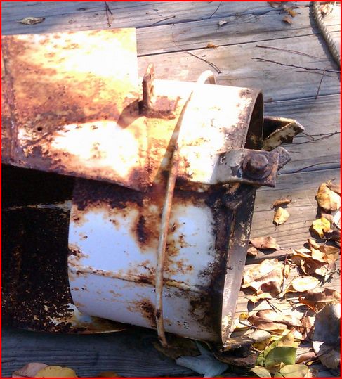

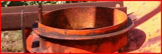

Curious if anyone might have ideas for a simple fix/modification for a binding 3 point snow blower chute.
The two close-up shots are not of the actual unit, but are similar to what I've got (seen in the "fuzzy" pic).
Instead of the 3 tabs holding the chute on, it has a split retaining ring which is installed below the lip on the snow blower end of things.
Then the chute is set on and the 3 bolts are attached to hold it in place.
The (sharp) bottom edge of the chute then rides on the lip (metal on metal).
Was thinking if the chute could be raised just a hair, and a set of nylon wheels attached to ride on the lip, things would rotate much easier.
Or would snow/ice build up and cause problems?
Maybe a matching lip on the chute end with an anti-friction ring (if I could find one - 10-1/4" inside diameter x 12" outside diameter)?
Also, the crank/cable mechanism is pretty bad.
Considering switching over to a chain and sprocket setup.
Or would snow/ice cause issues with chain as well?

Nothing wrong with rollers. But if you clean the metal up, put a good coat of paint on it, then smear on some white lithium grease... you should be good to go. Keeping it inside out of the weather would be a big plus, too. A normal chute that gets some yearly PM usually has fairly polished metal surfaces and is fairly easy to turn. Only time there may be be some binding is when blowing a heavy stream of snow and the chute 'rocks' back a little from the force of the snow. Other times, it is just kind of sitting there and you can turn it with your little finger.... My JRW has the same ring it sits on, and turns just fine... My chute is about 12" in diameter... :)

Thanks for the input, I cleaned the chute up with a flap disc and the paint is drying.
Will get it greased up and mounted to check it out before looking at any modifications.
Would definitely like to modify or eliminate the hand crank.
Haven't had it on the tractor yet but looks like I might not be able to reach it from the seat.
Your winch setup looks good, any issues with it? And is the roller spring loaded?
-Neil

Got the chute and mating surface all cleaned up and painted and re-assembled with lithium grease (as recommended).
Works great now !! Next step will be to get it mounted and see how easy it is to reach.
