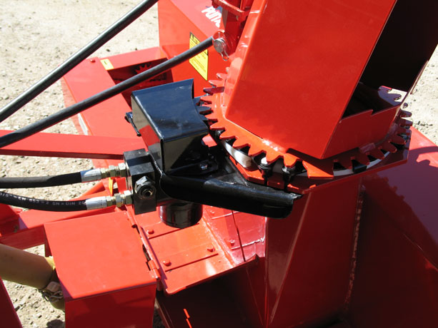

I'm preparing to order a 3pt snow blower and would like to determine if one
type of hydraulic chute rotation is better than the other! I would think that
the hydraulic motor would be less problematic than the cylinder in this
application (less chance of icing up), but I'm not sure.

I should have been a little more specific in my original post. I plan on ordering a
Pronovost Puma 74 inch snowblower, with hydraulic chute rotation. The cylinder
rotation mechanism looks like the picture below.
The hydraulic motor mechanism looks like the following picture.
As you can see, the cylinder rotation mechanism appears to be more complicated
and might be more prone to jamming from ice, than the hydraulic motor mechanism.
Has anyone experienced problems of this nature with similar mechanisms?
