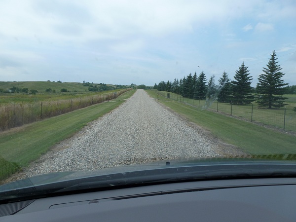

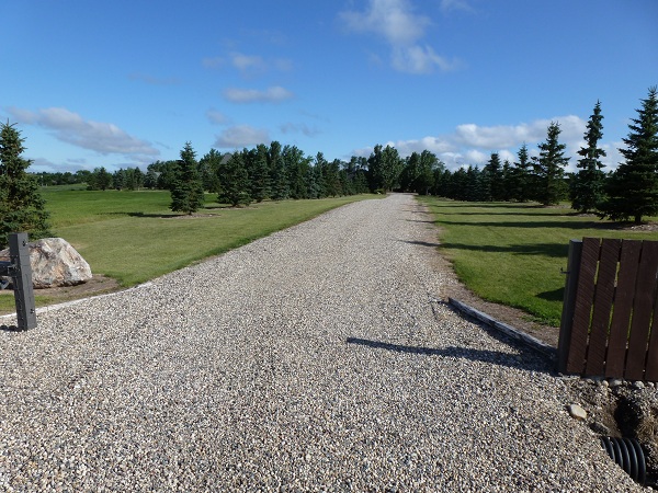

My wife and I are scheduled to close on a new place at the end of October. We'll be in the country and have a 1500' private drive we'll need to maintain. We live in central North Dakota so we'll likely have a lot of snow to deal with.
My current plan is to buy a JD 3720 with a 66"-78" blower but a friend that has a Bobcat Toolcat is trying to talk me into buying one. He doesn't blow snow with his but thinks it might be a good fit. I don't know much about Toolcats other than what I've researched online and read on various forums. We have two kids so the side by side seating would be nice but I don't know if it's worth the extra money. Would a Toolcat with blower work well in my situation or am I better off with a compact tractor?

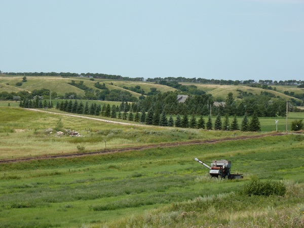

I've added three pics that show the driveway. It is relatively flat with around 1100' running east/west and 400' running north/south.
Any comments, suggestions, etc are greatly appreciated.

That's pretty open space. I don't think you're going to have a whole lot of accumulation if it's typically pretty windy. The trees may cause some drifting that could reach the lane depending on the direction of the prevailing winds. You could prune the bottom branches off to cure that. For your first winter, I would just contract a plow truck and see how it goes.

I have a similar drive way tho not as level and I use my Toolcat with a rotary broom for snow. Our snow is generally the dry powdery stuff that blows around and the broom works well until it gets over 15 inches or so.
I prefer the broom because the gravel would be hard to get clean without picking it up and that's tough on blowers.

I have a TC 5610. For that length of driveway, I would opt for tractor or TC 5610 with rear blade or TC 5600 with front snow plow. One pass up and down the road and you will be done for most snows. I have a 3 pt snow blower but it is much slower to move snow than a plow/blade. I use the blower only for drifts and really deep snow that can't be pushed easily. Blade the snow toward the side away from the direction of the wind. Then the ridge of snow will not cause drifting over the road.
I had a cabbed JD 3720 before the TC. A loaded cab 3720, FEL with a blower may be approaching the price of a TC with front blade. Extremely easy to change out front attachments on the TC. Just get out to hook up the hydraulic hoses if needed.
I have homemade front snow blade (made from a pickup snow plow), 3 pt rear blade, snow pusher, broom and 3 pt blower all for my TC. The front blade gets used the most, then the pusher, then the broom. The blower only for deep stuff. I will probably get rid of the broom in the near future. Can't use the broom near doorways well and it can't do deeper snow. I would not use a broom on a 1500 ft gravel driveway. Too hard to keep from removing the gravel and can't do snow well over 4-6" deep.
