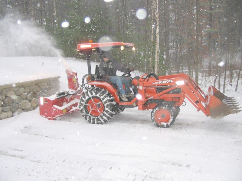

I use R4's with chains and the chains are only necessary because the driveway will turn to ice if the sun comes out and it then gets cold.
I handled 14" (measured) the other day with no problems.
