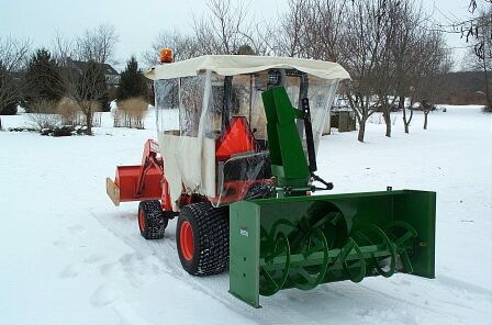

For large snow amounts a snowblower is the way to go. Slow moving but it moves it away. IF we get more snow this winter, which the way this winter is going, is a strong possibility, /forums/images/graemlins/grin.gif the snowblower gets the snow out of the way. With a plow, unless you push the snow further to the side, it will pile up, get hard, and your driveway will get smaller and smaller. I picked up a 54" Puma for $1000 last May. Attached is what my unit looks like. It will be geting a work out in a few hours. /forums/images/graemlins/wink.gif

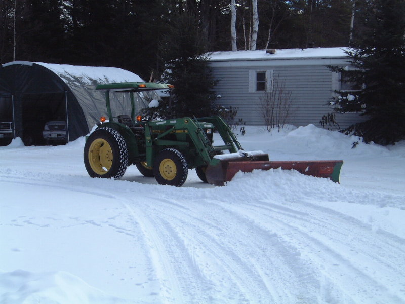

I can't magine anyone foolish enough to spend that kind of money on a plow set up. Especialy if it just for a tractor. If your buying a Brand New Fisher set up for a truck then that is another story.
I have to believe that anywhere in snow country there has to be a supply of old truck blades, Fishers, Westerns, Meyers, sitting in junk yards, back yards, behind somebody's barn, out in the back field etc. etc.
With a little common sense and some good old yankee ingenuity you adapt it to the front of your loader and you got the best of both worlds. The bucket for moving back the snow banks and a front mounted blade for pushing the snow around. And you won't have to deal with a stiff neck from always trying to look behind you.

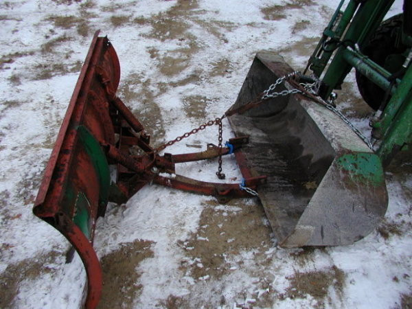

You can't get a more jury rigged set up then mine and it works Great !!!!!. As I have said before, Power angle would be nice but not worth the $700 it would cost me to do it right. Maybe some day.
As you can see from the attached picture, mine is locked into place with a chain and a chain binder. Once in a great while I need to tighten it after I have installed it or re installed it. But it doesn't move, it doesn't fall off, I can angle it by pulling a bolt on the appropriate side and swinging the blade and then drop the bolt back in the appropriate hole.
I have cleaned up 14' - 16' storms almost like you were sitting in nice comfortable plow truck. But how many plow trucks do you know of that within minutes of undoing a chain can be stacking up snow banks with the bucket loader.
Sure a front mount snowblower would be the ultimate, but not for the $$$ they cost. You guys can have your rear mount snowblowers and your rear mount blades with your stiff necks. I'll stick to what I have because it works fantastic and I have only maybe, $25 invested in it at the present time.
