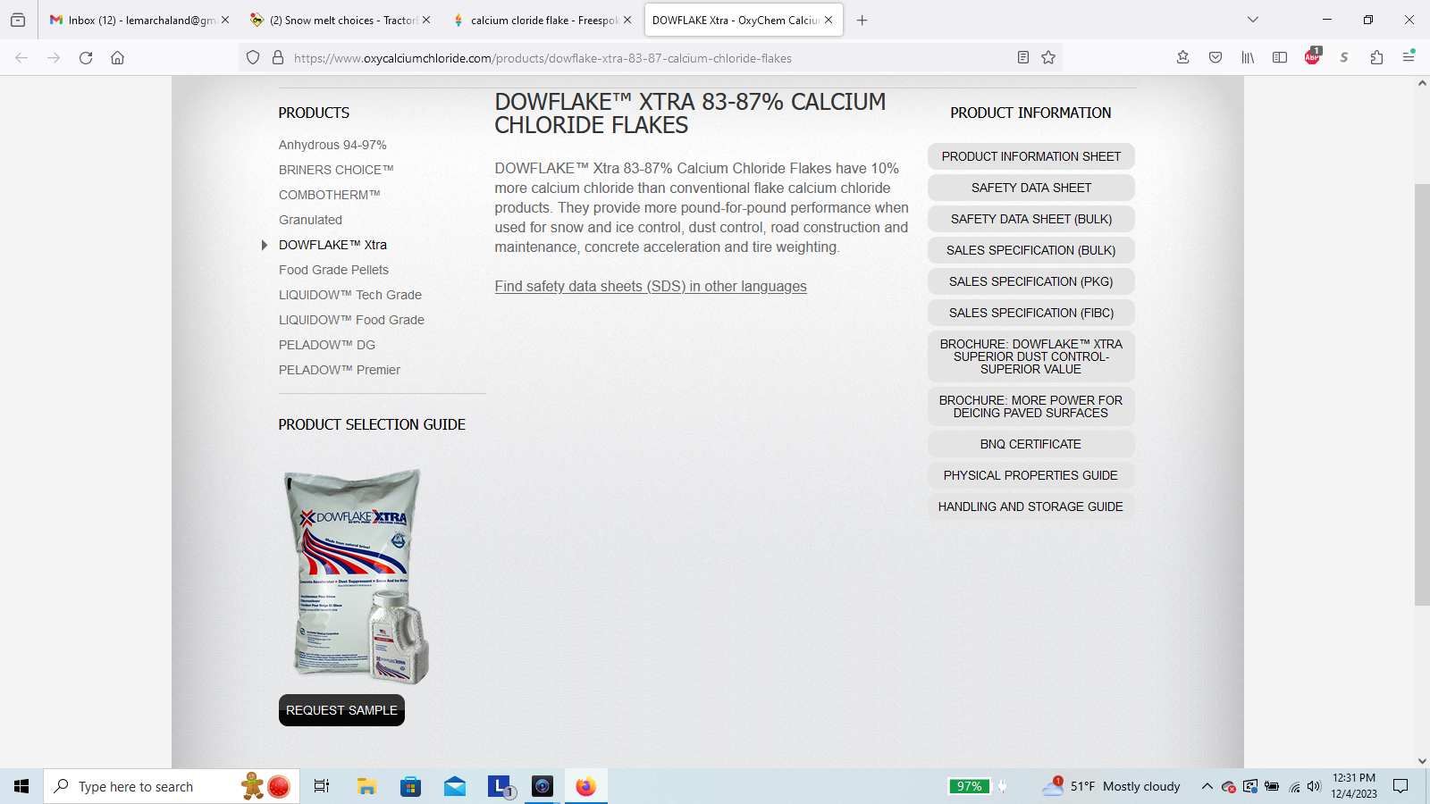

I use solar salt in my water softener and it works good on an icy driveway. It comes in 40 pound bags,about $7 per bag. If you use 40 tons a year it’s not going to be cost effective but if just a few hundred pounds it would work well. I’ve found it doesn’t take much, my driveway is 600 feet paved and 20 pounds or less works on it if it’s glare ice.
/ Snow melt choices #7
The pet friendly stuff just isnt salt. Its mag chloride or sodium chloride. Mag chloride is the same stuff people use to put in tractor tires. You can get it in flake form for alot cheaper than in a bucket.
Prety much everything is going to need to be covered.
I hadn't heard of anyone using magnesium chloride for liquid loading of tires, I have heard and have loaded tires with calcium chloride.
At $15 to$50 per bag it isn't inexpensive. I try and keep a bag or two around for when it gets real cold as it will melt ice long after salt quits working.
