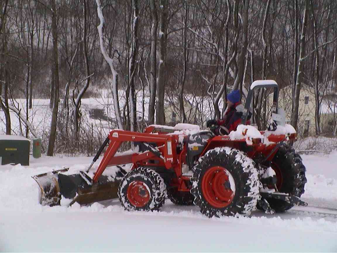

I saw this idea on this forum and when I found a 8' Meyers plow for the right price (yes, free), I could not pass up this. Attached is a picture of the snow plow in use.

More details about the the photo. My tractor is a Kioti DK-45, with Rhino 2409 FEL and water/methonal filled tires (good for minus 15F). Have chains for tires, but with filled tires and plow instead of bucket, don't seem to need them.
My driveway is 1/4 mile long and paved, with curves and a 10% grade at times. This system seems to work great, but I need to keep the plow pivot point low to the ground to work properly.

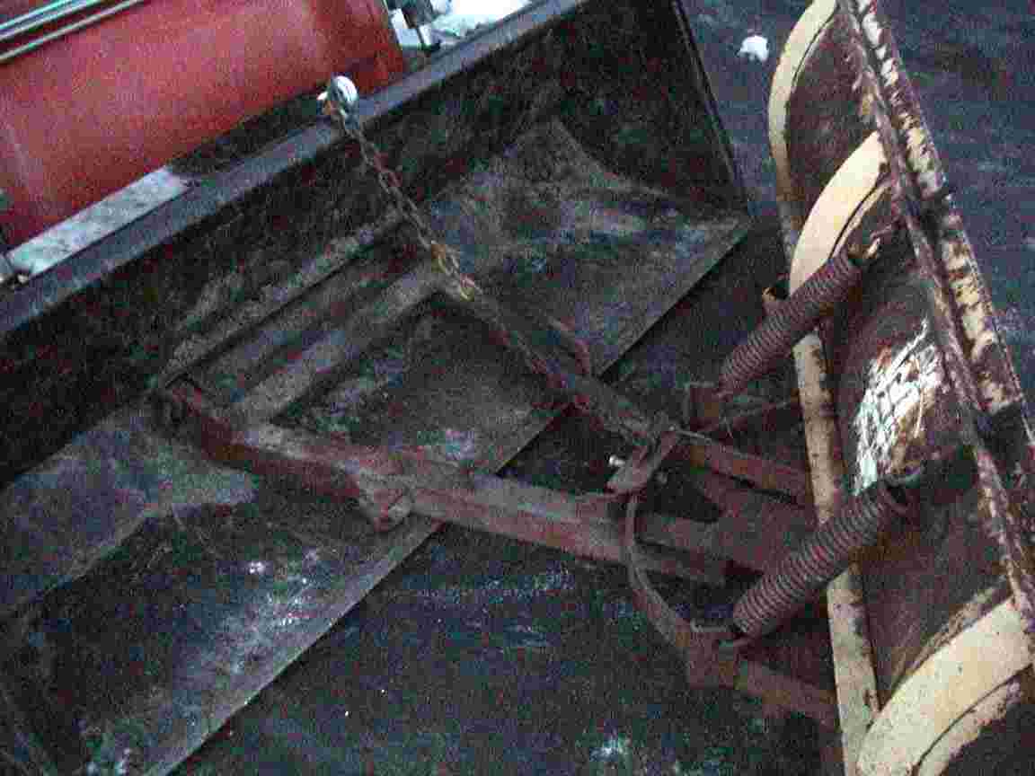

Here is how I attached the snow plow to the bucket.

I know a guy that wants to do this for his tractor......He is worried that with having the blade that far out from the front tires the the snow with an angled blade would shove the tractor sideways. Are you having this problem at all? Are you able to go fast enough for the snow to roll off the blade to the side? Looks like fun!
   / Snow plow attachment for my FEL
I have no problem now that I know how to best use my setup. Basically, I need to keep the bucket as low as possible in order to keep the plow level with the pavement. In this configuration, the snow moves off to the side quite nicely. Last time I plowed was 8" of heavy snow without a problem. I'm sure if the snow was either thicker or heavier, I might have a problem, but then, I'd just push straight to break it up and then move it off to the side.

The plow set-up looks great. I tried something like that without the trip springs etc...and it tended to act more like a dozer on my blacktop driveway. I've read of others doing what you did and it looks like it should also work for me. Could you detail how you connected to the bucket? The picture makes it difficult to tell. Did you weld some angle iron on the inside of the bucket? Appreciate any information. I may give it a try.
   / Snow plow attachment for my FEL #9
JLong, when I built my system I used 6" channel iron and angle stock to build the bucket mount. To this I welded (not I but the welder I use in the area) the plow clevis frame. Then I had to set the plow in the bucket and level it at the height I wanted the plow to operate at ( like what was said before , you want the bucket close to the ground when plowing, not on a steep angle downward). Then I set the chain to a hook in the middle of the bucket so that the chain was tight when I raised the bucket and the plow A- frame was off the bucket cutting edge. I used six 3/4" stainless bolts to attach the mounting frame inside the bucket. My system didn't have the sector and pin that I see in the above attachment this makes it very easy to set the angle. I am about to start making a new system for my BX2200. I will be using a 54"- 60" Cub Cadet Super Garden tractor blade or an older 60 inch Kubota blade for the new system. They both have a sector and pin setup and they both come with skid shoes. Mark
