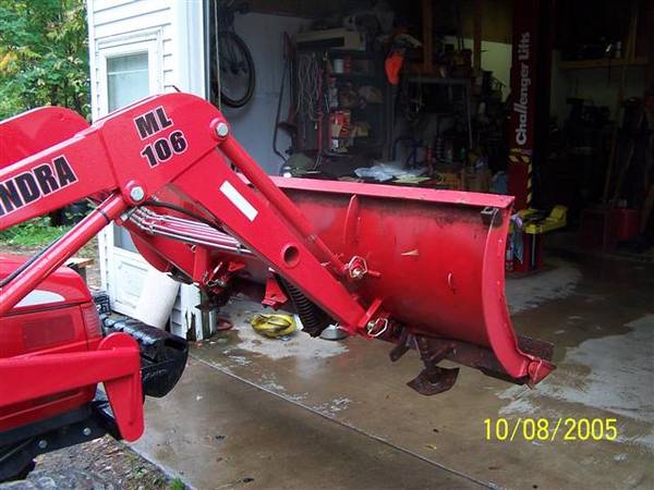

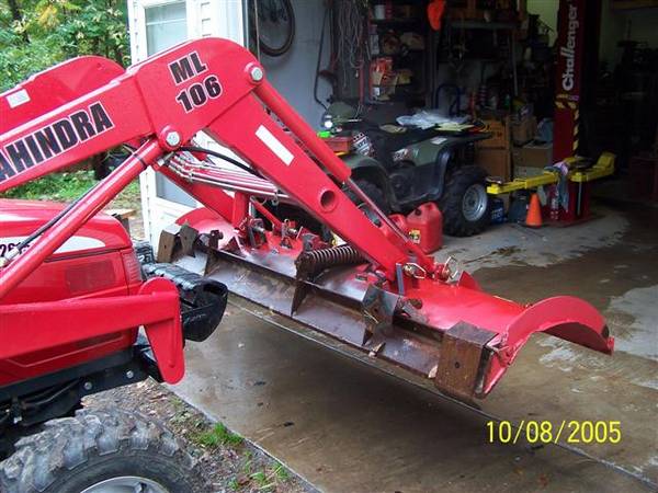

   / Snow Plow Chained to FEL bucket- would it work? #7
My loader bucket was attached with 4 pins that go thru and large E-clips snapped over the ends. I replaced them with 4 1" pull pins I picked up at Tractor Supply.
I also have a 7 1/2' plow blade that I welded brackets on. Now if I want to use the plow I pull the 4 pins, remove the bucket, and attach the plow blade using the same pins. This is probably similar to what you want to do.
You could chain it or use turnbuckles. I tried that but didn't like it. The plow stuck out too far in front of the bucket to suit me.
