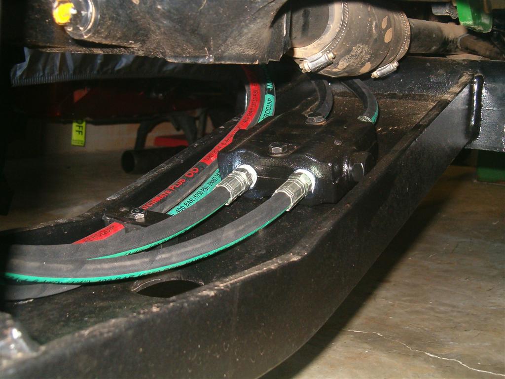

I have one. No damage as of yet, but I only used it for one winter of plowing.
If it has trip springs and power angling cylinders, both of these mechanisms are designed to absorb & relieve shock loads.
I'm sure there will be more expert advice forthcoming, but mine would be proceed with some caution, make sure you don't get over confident and start bashing piles. Keep the blade angled and don't plow in high range.
Here's my set up. I mounted a 2" receiver in mine to push/pull trailers around, too.
This was my protoype set-up. Since the pictures, I installed 90 deg elbows before my couplers to ease the stress on my hydraulic lines.
I would also like to install snow plow shoes on my mounting plate to keep the ends of the loader arms from digging into the driveway.

The angle cylinders won't offer much protection with out a cross over relief valve. I would recommend you get one for yours.
Even then if it is angled all the way one way and you hit a boulder:)p) on that side that is where the potential damage will come from.
Thanks for trying to find the flaws in my setup, but the cylinders do have relief in them when I hit an object. The reason I know is because I've already hit things with it and the cylinders give before anything breaks.
If that happens, the springs typically trip and jump over the object (stump, manhole cover, etc.). I guess if you hit a tall object like a tree or parked car with the plow angled all the way at high speed, then yes, you might damage the loader. Anyone plowing that way should probably not be operating a plow in the first place. lol
The benefits of being able to use the bucket and the plow without a massive changeover of equipment and expense outweighed the slight risk of damage for me.
Any plow can damage the power unit behind it. Just use common sense and caution and don't be scared. If we were that scared about everything breaking our tractors, we'd never get much anything done! ;)
