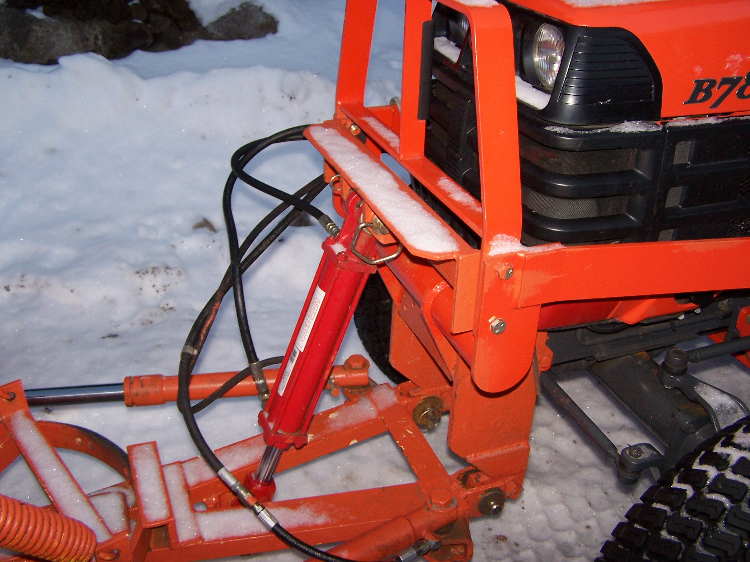

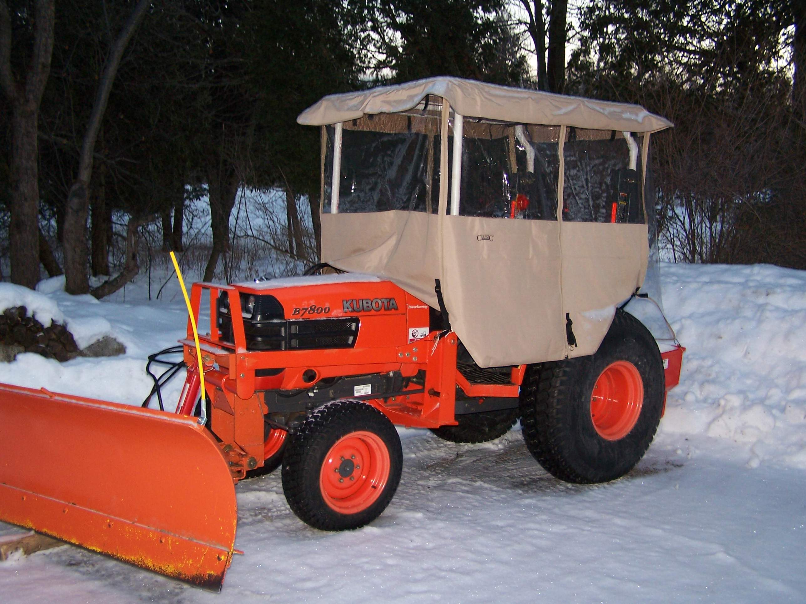

Congrats on your tractor. We have a 7200 that is running well at the farm down-state. My father put together this setup for about $400.00 including the golf cart cab. Used plows for trucks are everywhere, and tractor supply has everything else. This is a 7800, but the 7200 we have actually has a prince pump running off the rear pto to work the hydraulics. I'm not sure if your 7200 has a loader on it, if it does, you should be able to fabricate something similar to what you see here.
That 7200 is an awesome machine, ours has over 1300 hours and I don't think it's even broken in.
