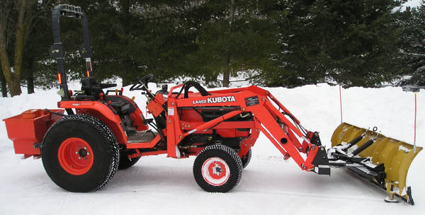

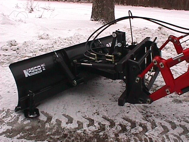

Here's a couple pics that I've saved from members on here. Hopefully someone that's done it can help with details.

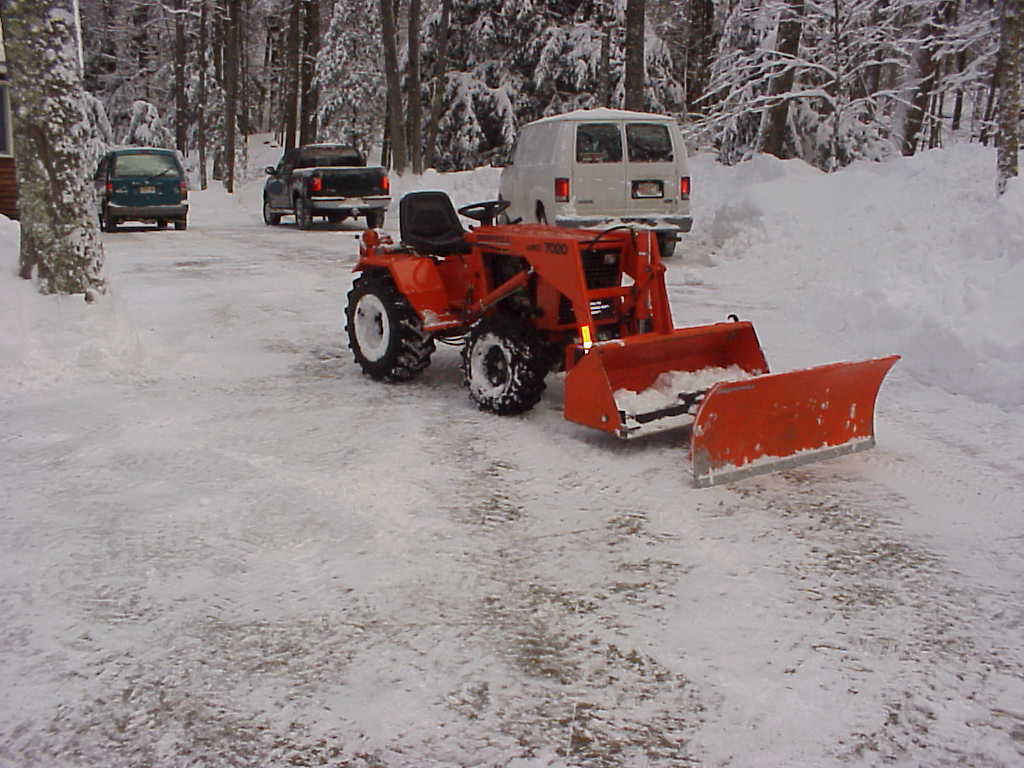

Do a search for "FEL SnowPlow"...
HERE is one I built.
HERE is one Jason built.
Here is one Mike built.
And there's plenty more if you do some searching:D
   / Snow plow question #5
Yeah, there ya go!!! I had your pictures saved but for some reason I couldn't get them attached to this thread. Good job on yours Kennyd. I also couldn't remember your name to reference you about your project. I saved yours because I thought it was very well done!!! :)
