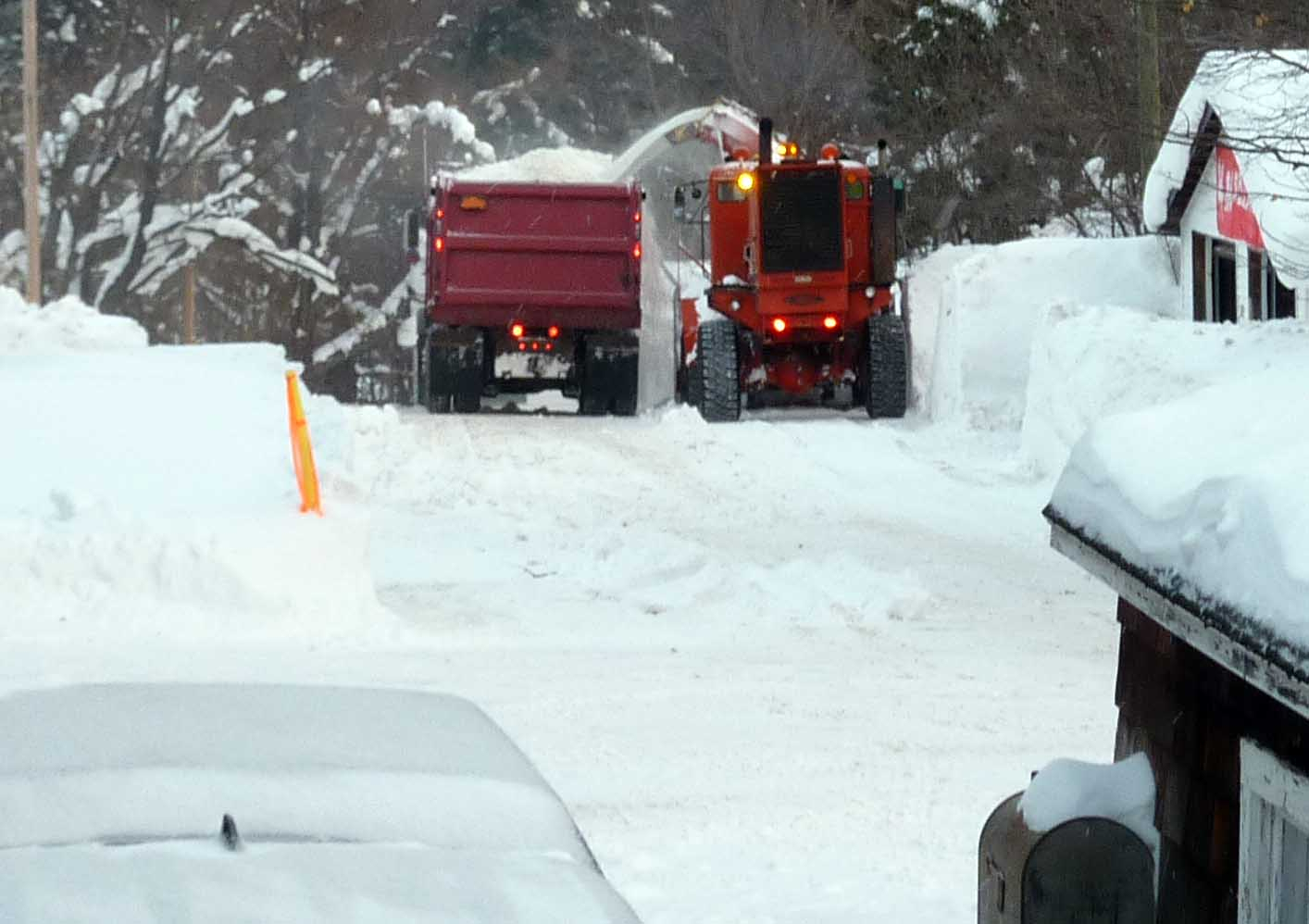

Oh but some of us do get snow! :LOL: The street we reside on. In the bottom right, is a tad of our garage.
I'm really here to see what the responses are.
