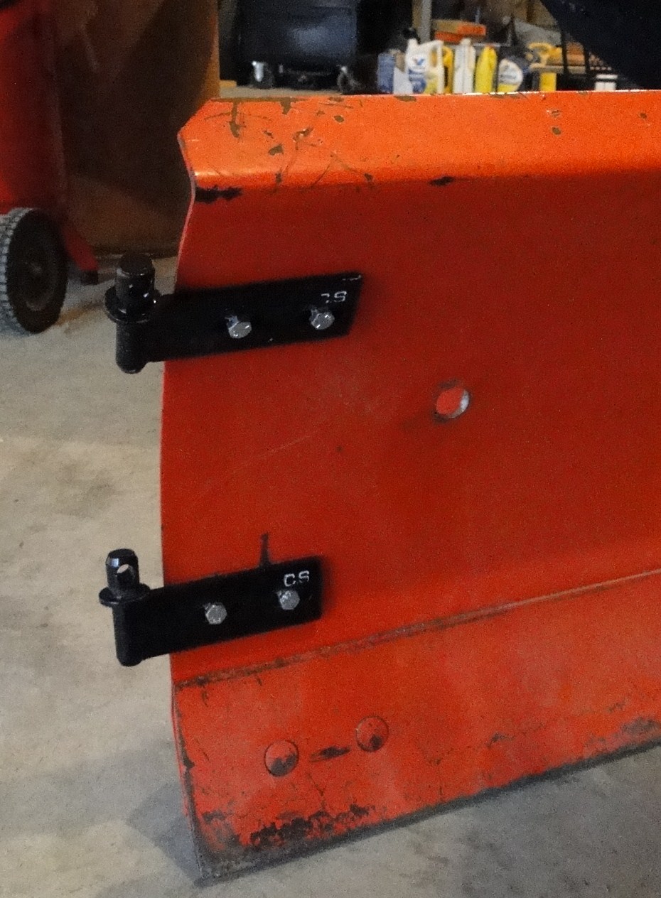

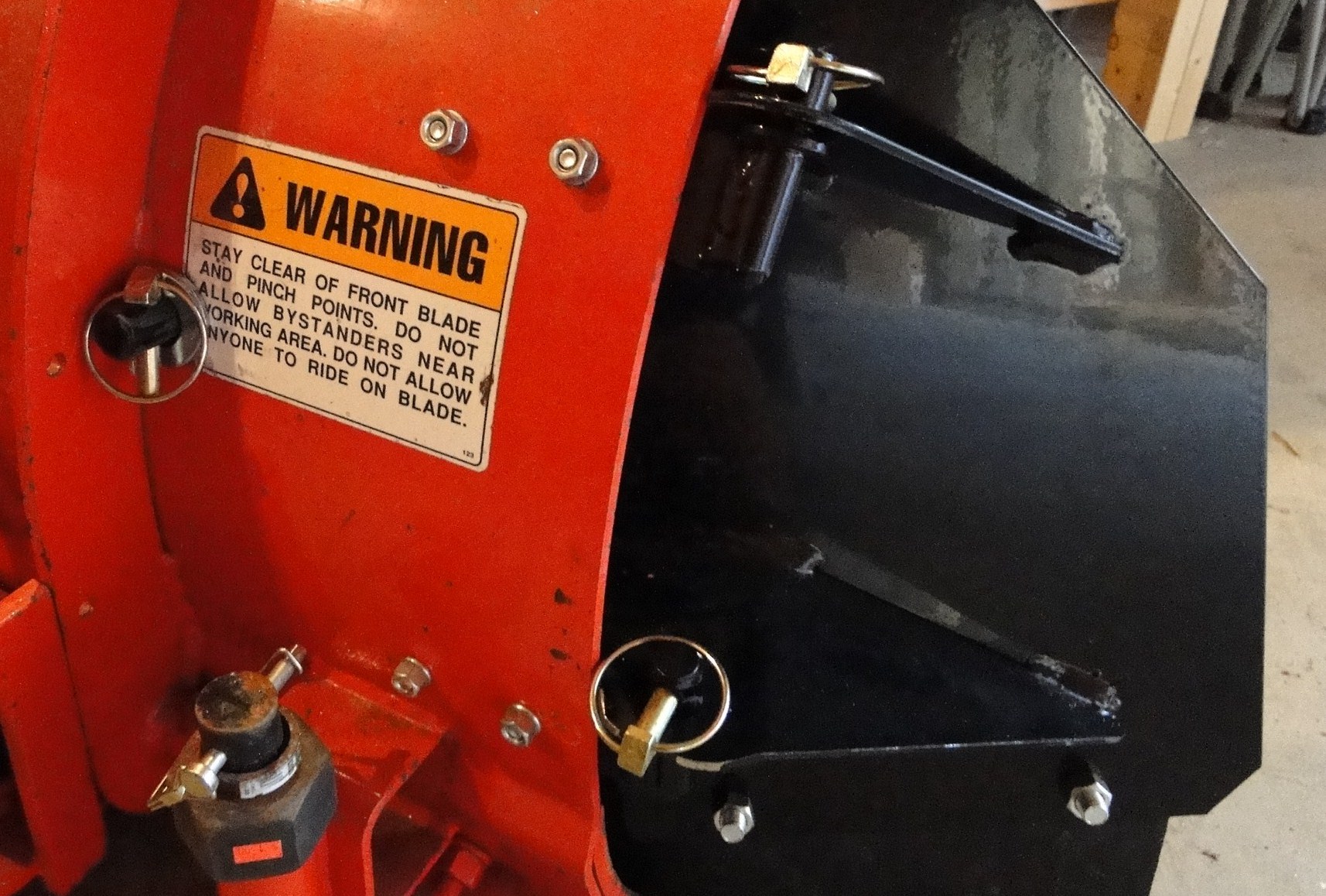

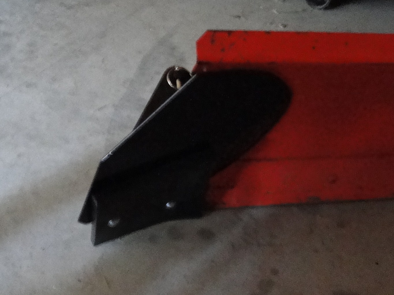

I added a set of wings to my 60" blade over the summer but haven't had the opportuity to try them out yet. They are the PW22 model available at Northern Tool and added about a foot to each end. They are secured using brackets and pins so they can be removed (the wings but not the brackets) very easily. Search the "snow removal" forum for the thread, which has several photos of the installation.
   / Snow Plow Wings #4
by wings do you mean a gate to convert the blade to a push? or simply to lengthen the actual blade??
   / Snow Plow Wings #5
Here are a few photos. They both add length and help to keep the snow from trailing off the sides. Sort of halfway between a straight blade and a pusher.

Those are Buyers Pro Wings. They are decent and available cheaper at places other than northern tool. They have a rubber cutting edge and if you catch something with the wing itself they will bend. But they are great for the money. You just have to treat them nicely. Biggest benefit with wings is the ability to carry snow.

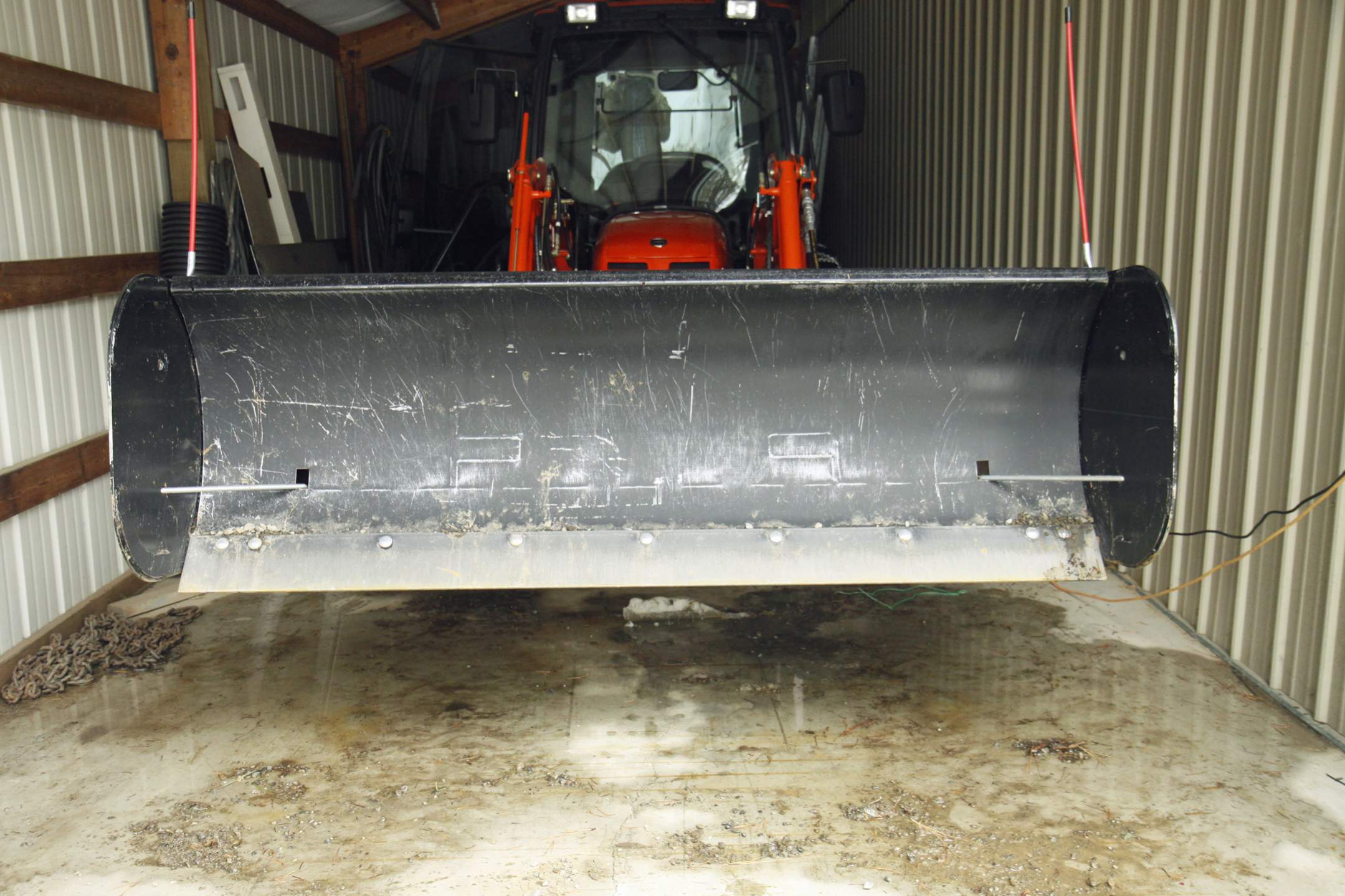

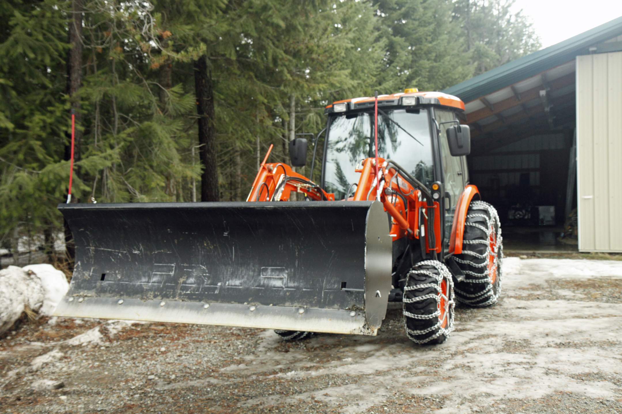

These came with the blade I purchased from quickattach. They fold back out of the way when not needed.
   / Snow Plow Wings #10
hay...i have the same thing :)
so far im VERY impressed with the blade also.
