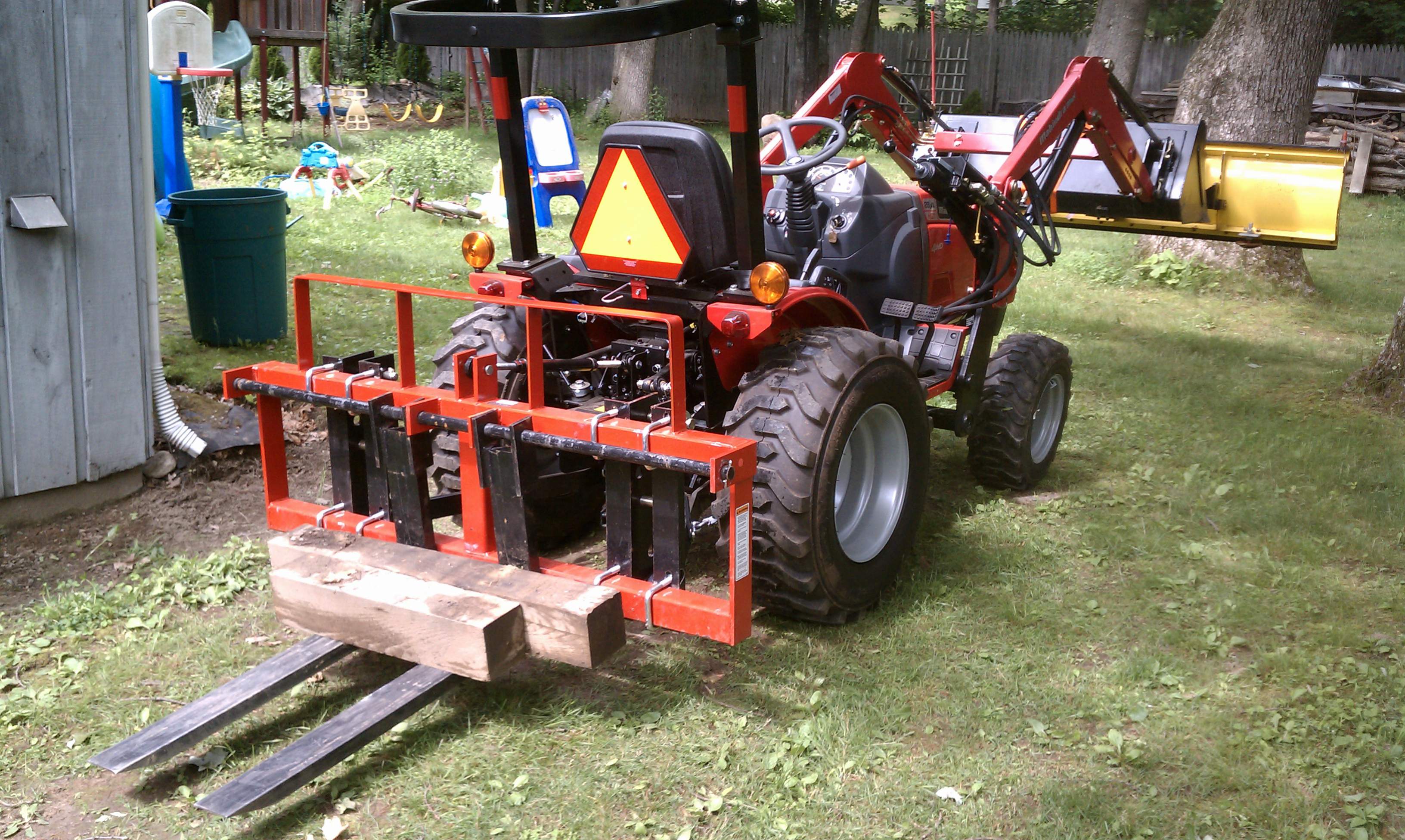

I use a plow on mine, I personally don't like it, I actually want a frame mount plow so I can take off the loader. If you want it hydraulically angles yes you need a 3rd function, or can Manually angle it but that's too hard.

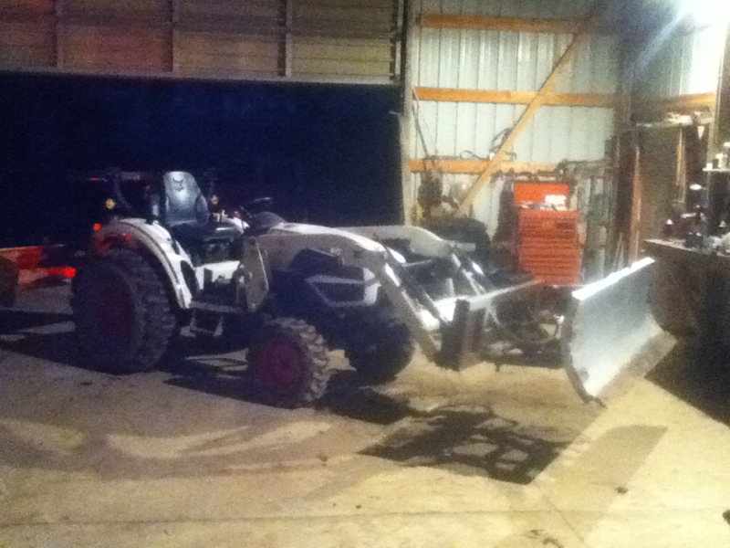

Newbie question.
First tractor. Plan to cinch Snowbear winch lifting (plan to remove/disable winch), manual angle, plow into the bucket. It would ultimately look like your setup (except bucket still on, and plow chained to it)
Can u be more specific as to why you want the loader removed from the equation? I was thinking the loader provided an unlimited ability to pile the snow to the sky.
Heres a pic of a "test" hook up... not the straps I plan to use...
Appreciate your insight, as you have (negative?) experience with what I was looking forward to doing.

Newbie question.
I have a long lane to plow (through a woods), and it just throws my tractor off to the side and can't push it off to the side far enough.
And yes you can pile it higher with the loader plow, but I have plenty open space and if need to I have other equipment to pile it higher. And I need to plow smaller areas, the loader plow swings too far out and misses snow.

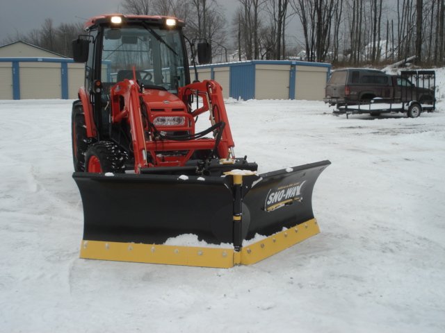

Why is this anymore riskier than shoving your loader into a bank or a pile of dirt? You dont put equal pressure on the loader arms when pushing into a pile?
I have plowed for 10 years with a loader mounted plow.
My first was a 30hp Cub Cadet with a Meyer 7-1/2' plow and now this one.
This is a 8-1/2 Snow Way V-Plow
