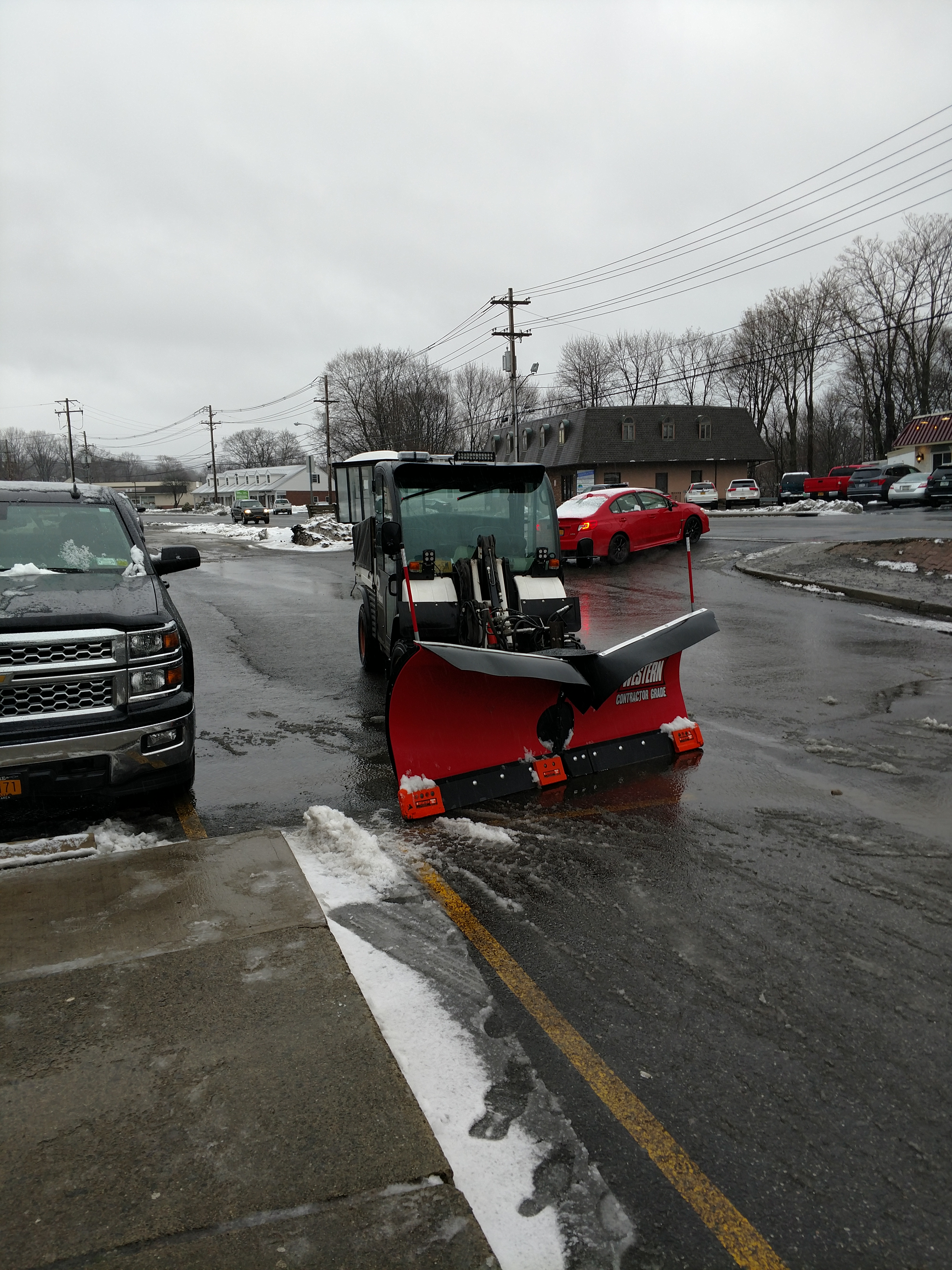

Hi that is a 8 1/2 western MVP3 I built the mount for it, it is awesome,
