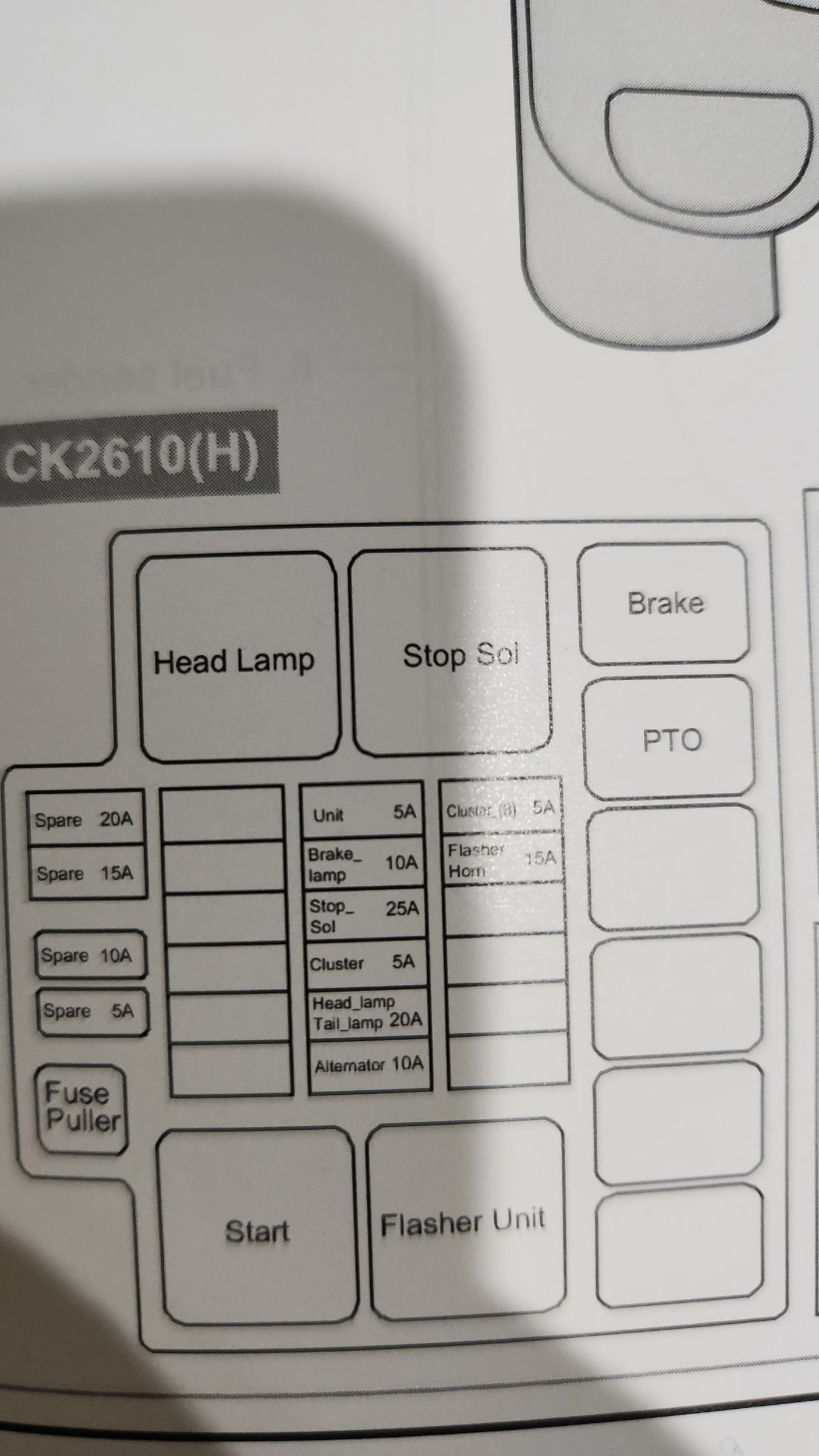

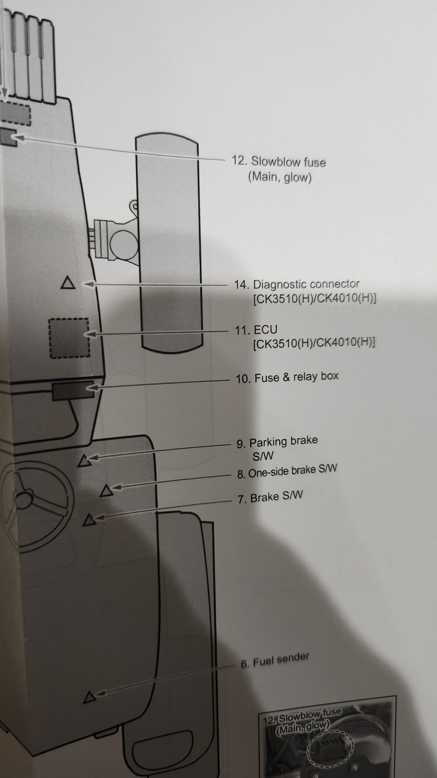

   / Snow removal and dead tractor - looking for manuals CK4010chse #4
Looks to be under the hood, back towards the cab.
Not the best pictures, but you can only expect so much from taking pictures of a book with a phone.
View attachment 784373View attachment 784374
I found this and checked a few of the fuses and they looked ok. I did not check them all. Mostly ones related to lights as they did blink a couple of times.
Should I check them all?
Thanks,
