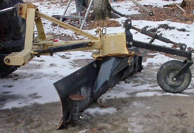

On my Kubota I've got the same setup for the rearblade and it works well. For the amount of snow we get in this area I can't justify the cost of a snowblower. Front end loader is used for the deeper drifts or to cut the banks from the state plows. Of the driveways that I do there is only two that are blacktop.
I attached a picture of my blade that I took last year. Note the skid shoes are turned up. Last year we got less snow than we got in the storn this past week.
Gordon
