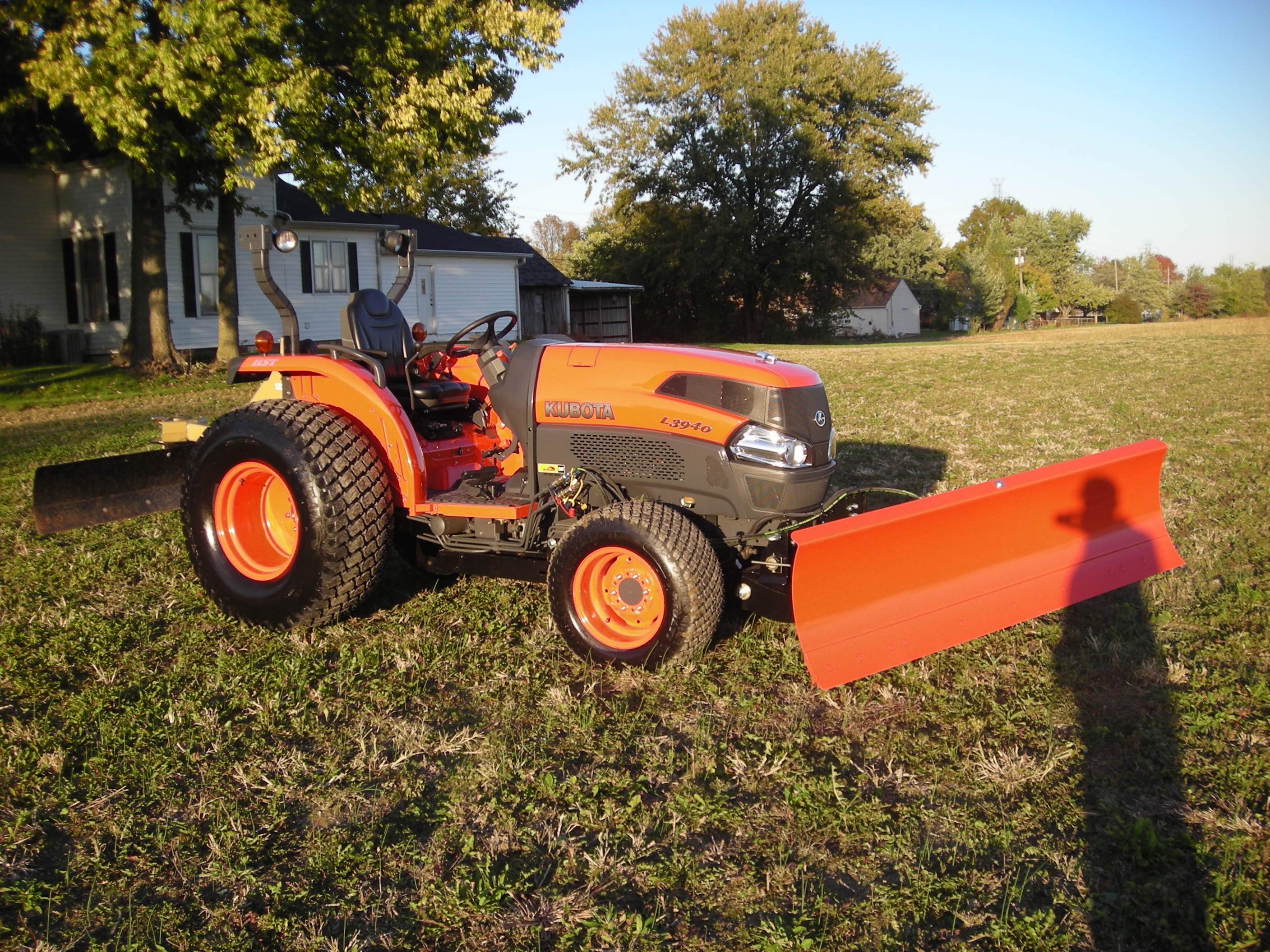

Are you sure you can't get a two stage snow blower for your JD GX345? I would strongly consider this if the comparison cost makes sense. Snowblowers are very effective unless you have light snows. I have a JD LX188 with single stage snow blower and it does a fine job, especially in smaller areas and heavier snows. For 10 years I moved snow with a Ford 8N, tires chains, and a back blade. Thank goodness those days are over. The back blade is not the most effective tool for moving heavy snow. I maintain about 450' of blacktop driveway. This L3940 and front blade is a very quick and effective. Philip.
