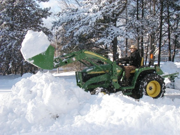

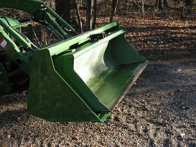

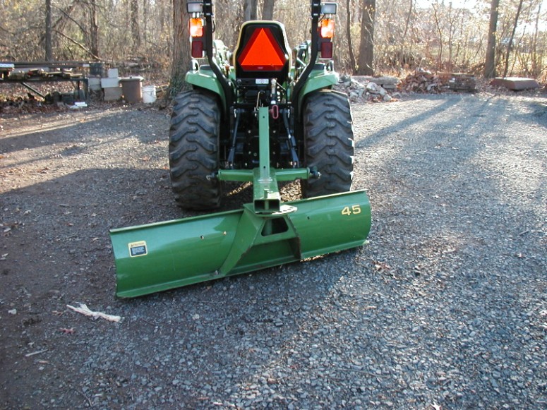

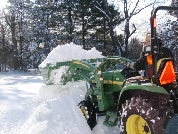

Every year the subject comes up regarding the best set up for snow removal,
1) the cleanest fastest way for heavy snow on paved surfaces would be front blower, least passes, no piles building up, but they are expensive single use implements, no loader on tractor for other tasks when blower is mounted, if you don't have a cab you will look like a snow man sometimes with the blowing snow, no good for gravel or rough areas.
2) front plows are fast in low to moderate depth snows, but quick build up of banks in deep snow.
3) rear mounted blowers, same pros as front mounted blowers but fast to put on and off, less expensive, still have use of loader, better have a flexible spine and neck, same snow man effect.
4) front bucket / rear blade (my set up), good all around application (not the best in all cases) heavy snow, slush, gravel and off road, moving piles, inexpensive. you will get a lot of seat time as there is spill over to go back and clear, you will have to get proficient in the use of the float feature, I had a one or two storm learning curve but some seemed to have a big problem with the float feature as many threads were dedicated to that subject, it can be frustrating until you get it down.
I picked up the high volume 72" bucket, does the trick for me, kinda like those big pusher boxes they use in the big plaza parking lots now.
Some of this I learned from experience and some from following past threads on this subject.
HAPPY THANKSGIVING EVERYONE !
A couple of pics of my set up;
