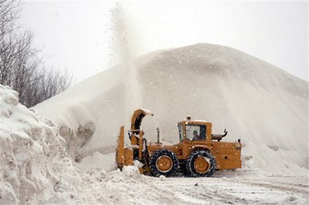

How about this for snow removal...
   / Snow removal using backblade/loader #4
I live 30 minutes from that area. If the wind would have blown a little differently it would have hit us. That lake effect is something else. 12 foot snow totals in 7 days for some areas. I like a good snow storm, but that is way out of control.
Hope nobody left there small car untended....yikes.
