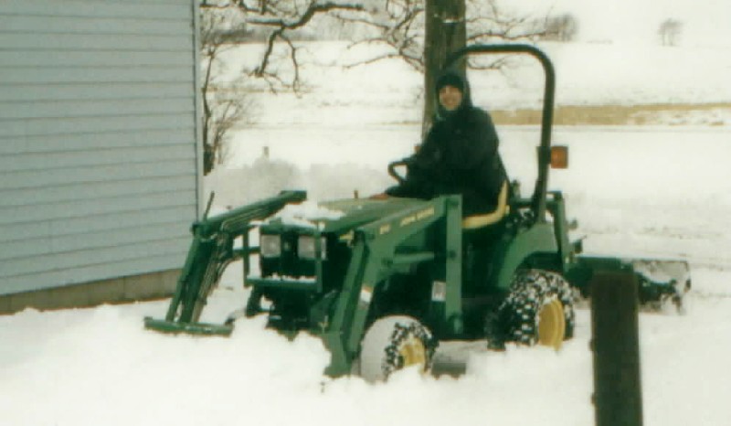

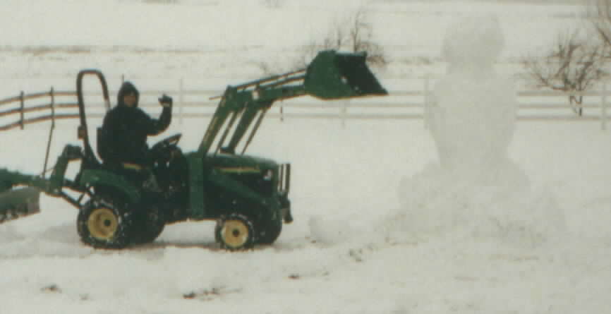

I use the FEL for scooping out corners or for pushing some times. Otherwise the bucket is just too darn small. I've found that driving backwards pushing with the rear blade moves the most snow. the rear blade equiped with skid shoes. I'm hunting for a bargain on a front blade.
