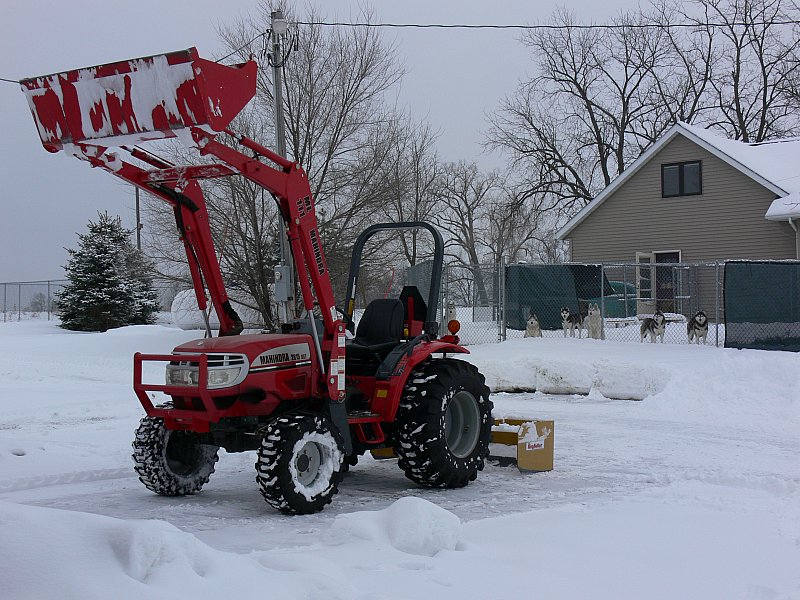

I've found using the FEL to be more of a pain in the A*** to use by its self. I have a box blade that I modified with a pair of wings to help move the snow into piles and then use the FEL to finish moving it to bigger piles. The nice thing about the box is you can go either direction without having to get off and change anything it works great in both directions. As you can see from the picture how it works in reverse and when going forward you can haul it to another area and unload it. I think it works better than a blade as you can see in an earlier picture before all my modification how well it moves snow.

I don't know what your drieway looks like, but after doing mine for a few seasons with the loader, I decided to buy the back blade, I can do the driveway in 1/3 of the time I can with the loader. The loader is handy for moving snow piles around though.
