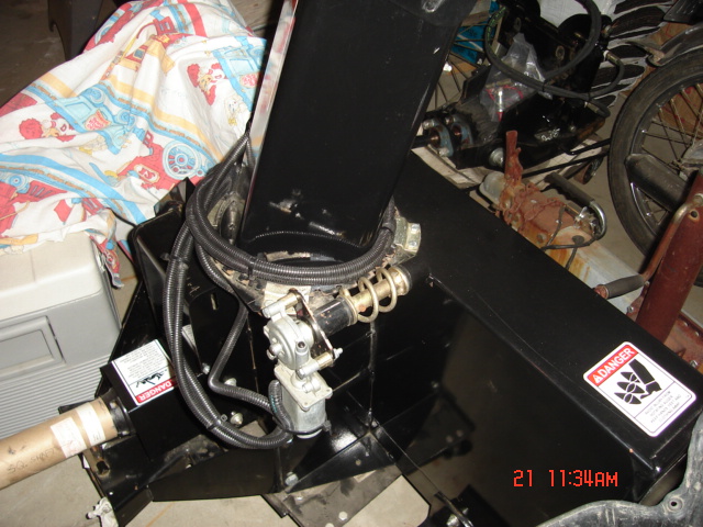

I use a Toolcat with a BobCat SB240 72" snowblower. I always find myself having to get out of the machine and remove the ice from the chute rotation chain. The ice will stick and build up on the chain and/or chute surface which then prevents the chute from rotating.
Does anyone know how to remedy this problem?

Wow, Roger- that's a toughie. I don't think you'll ever avoid frictional heat buildup in the chute, and resulting melting of snow.... my blower uses a worm drive, which stays relatively open, though I do always have to remove/chip away at any melted/frozen buildup before putting it away or the chute will actually freeze to the base-- but the worm drive's usually pretty clear.
Perhaps, with all pieces warm & dry, a good spraydown of silicone, allowed to dry completely before use? Or have you tried that already? I get the impression that a chain lube would not be he best thing to use, as snow might tend to stick to it....

I also struggled with this problem on my SB200 blower. I tried quite a few spray-on lubes but without a doubt the best thing I did to alleviate this problem was switch to a chain lube that has graphite in it. (Maybe they all do.) Until I found the chain lube I was going to create a waterproof fabric "skirt" that I could hose-clamp to the base of the chute that would hopefully afford some protection to the chain and the rotation motor. You can find very large hose clamps on the i-net, BTW.
Since my wife is quite the sewing nut, I probably will eventually ask her to create the above-mentioned skirt; however, I can't say that I'm in a big rush as this lube has made a big difference. I lube the chain/motor sprocket about once or twice a week.
Quick-Attach blowers have a very similar chute rotation setup as BC blowers in this regard and I would imagine they would suffer the same icing problems.

I've used Fluid Film on all the moving parts for the last several years and so far so good.

After using regular chain lube spray on the chute rotation chain every few days, I do not have chute rotation icing problems now. Thanks!
