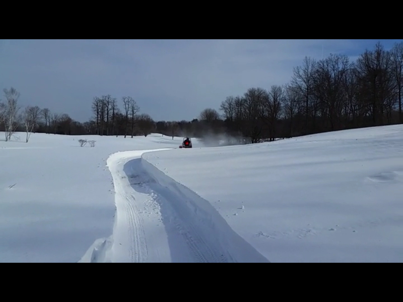

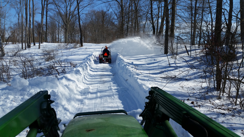

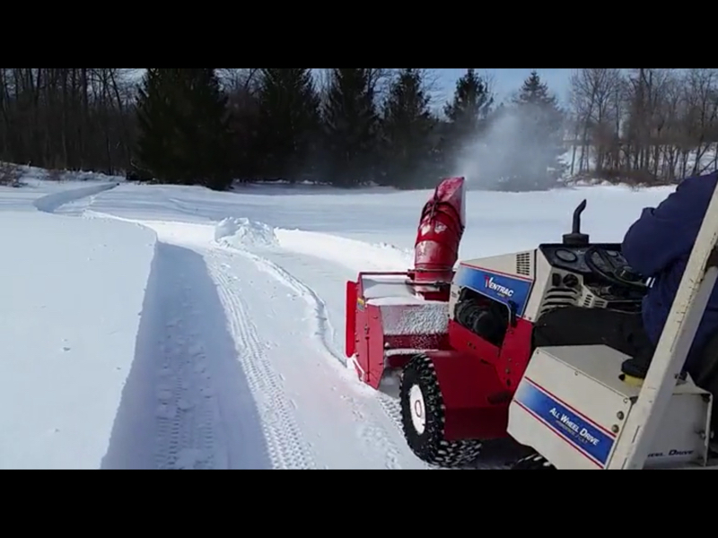

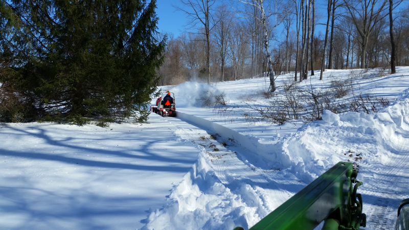

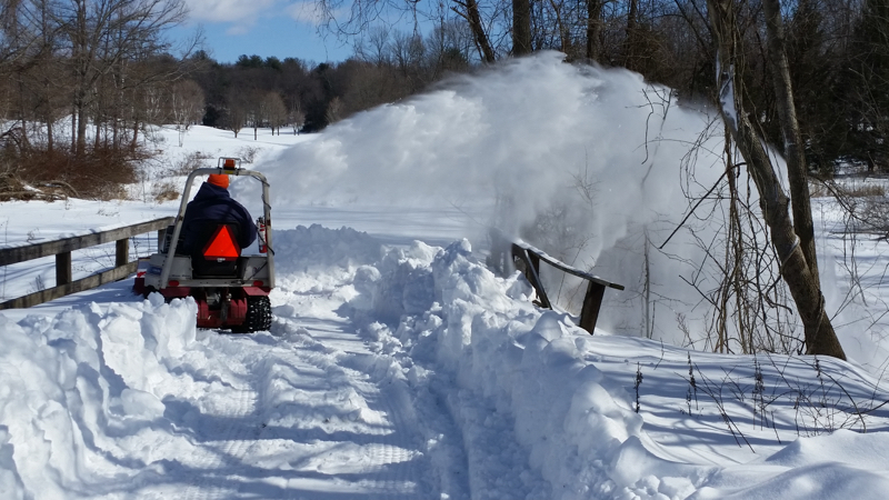

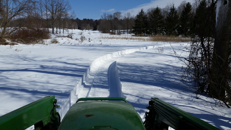

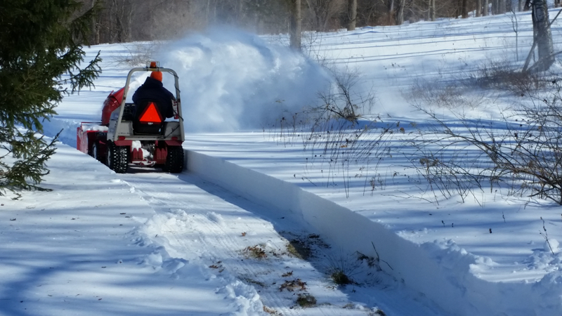

The last couple days I've really been putting my ventrac and snowblower to the test..we got a lot of snow here more than usual and we got it in the early start on getting the greens cleaned up started at my buddies course,he's got 20 greens to blow off,I've got 10...we burnt a couple blower belts up,The Steiner originally recommends an a series belt,put the blower was meant for machines that had 20 hp or less,the 31 was tearing thru an a belt every 15 minutes...we finally found a B series belt that was cut not wrapped..it's working perfect,now we can fully utilize the power without fear of blowing a belt...The snow we were blowing range from 18 inches up to over 3 1/2 feet. It's not loose light snow, it's packed in several layers it's the total accumulation for this entire season.The average depth seems to be 20 to 22 inches .The old Steiner SB 348 blower may be old but it still can do the job. I would love to have a brand-new 52 inch ventrac blower,I just don't have the money,this is working really good actually.

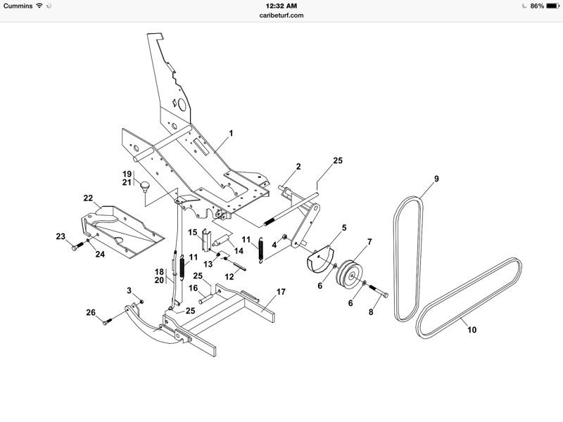

I noticed that when I mount my 60" side discharge mower, the implement (lower) belt rubs when raised, and I can smell it burning, so I have to remember to disengage the mower PTO when moving around with the mower up. Any thoughts on that one?

I think the fact that it's rubbing proves there is a problem with lower pulleys mount. When the double pulley comes forward and rubs against the mounting arms that usually indicates the Welds have broken or the mounting rod itself is bent underneath.Fix this and your belt problems will likely go away.it's not difficult to look at and figure out what's wrong this part of the tractor is very easy to get to. Remove the implement and either put down something to lay on if you don't have a nice clean floor.with the machine cold I would pull on the lower pulley mount, see how much play there is ,make note of any Forward and reward movement at this time.because it's so easy to do I usually just pull the lower mount off .i start on the side with the disengagement lever for the PTO drive there should be a cotter pin that holds the lower mount from sliding right out of the frame. I would take your pliers and get that cotter pin ready to come out,on the other side there will be a pretty stiff spring that holds the idler pulley up towards the machine remove that spring at either the mount or the frame.The idler pulley should now flop down towards the ground. Now go ahead and remove the belt tension adjuster by spinning counter clockwise until it falls off now simply slide the top belt to the engine off and remove the cotter pin you straightened in the beginning,and that whole lower amount should be able to go towards the rt side,once it slides out of the frame on the left side it should then come down and out.Get it up up on the bench and take a look and find out if the 5/8 thick rod is bent or if the pivot point welds are broken,or the back of the mount is just bent.i've got so much on my machines I can do this in less than five minutes it should take you 10 minutes tops the first time so I want to take a look and see what's wrong .

Number 25 is going to likely be your problem
