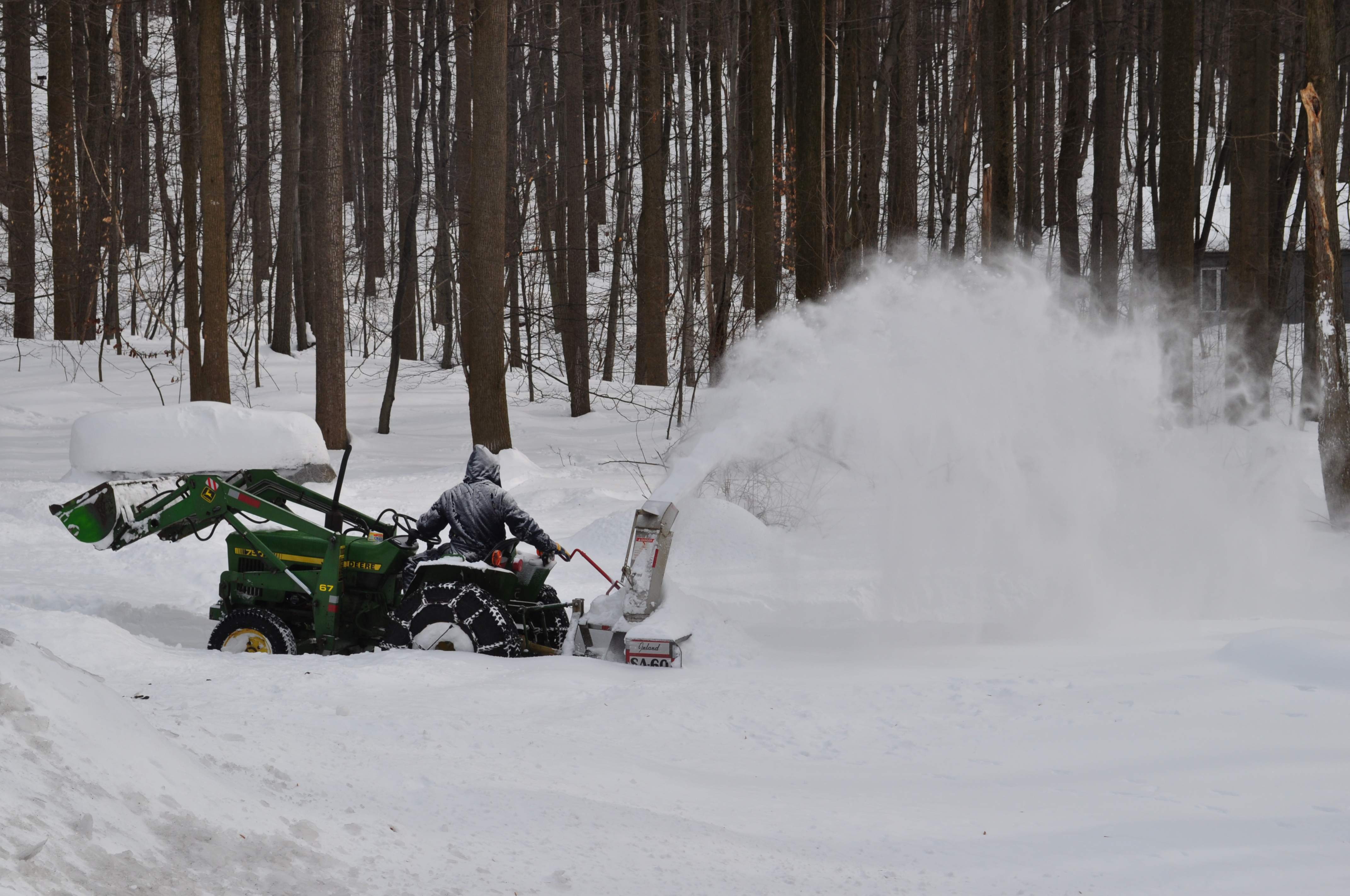

Someone I know has a 5 year old 60 inch 3pt blower he`s willing to sell .
It only has about 5 hours on it but was stored outside and is starting to rust .
I want to use with my massey GC2400 .
He wants $800 for it . Would that be a fair price and what is the average prices on new ones ?
Thanks for any advice
   / Snowblower price
Thanks Aaron, I'll try and get the brand name .
   / Snowblower price #4
I don't know how wide your Massey is, but if the snowblower is not at least as wide as the tractor, it will turn into a pain. I've passed on several good deals that were too narrow for my tractor. Some have put some "wings" on to get the width they need...
   / Snowblower price
Thanks hawheye08, my track width is 46.9 inch
   / Snowblower price #6
Thats a steal. New they are several thousand. Id buy it. Snowblowers take a lot of power, thats why they are usually one size smaller than most implements, and therefore usually not much wider than the tractor.
   / Snowblower price
Thanks Wolfy , do you think 60inch will be too much for 19 @ P.T.O. hp ?
   / Snowblower price #8
My previous gear driven tractor only had 18hp at the PTO and it had no problems powering a 60" rear blower (JD 750). Used it for 8 years before upgrading to my current tractor.
   / Snowblower price
#9
Thanks moship, I told him tonight I was buying it so he`s going bring it in his garage to sand it and paint it for me :) .
