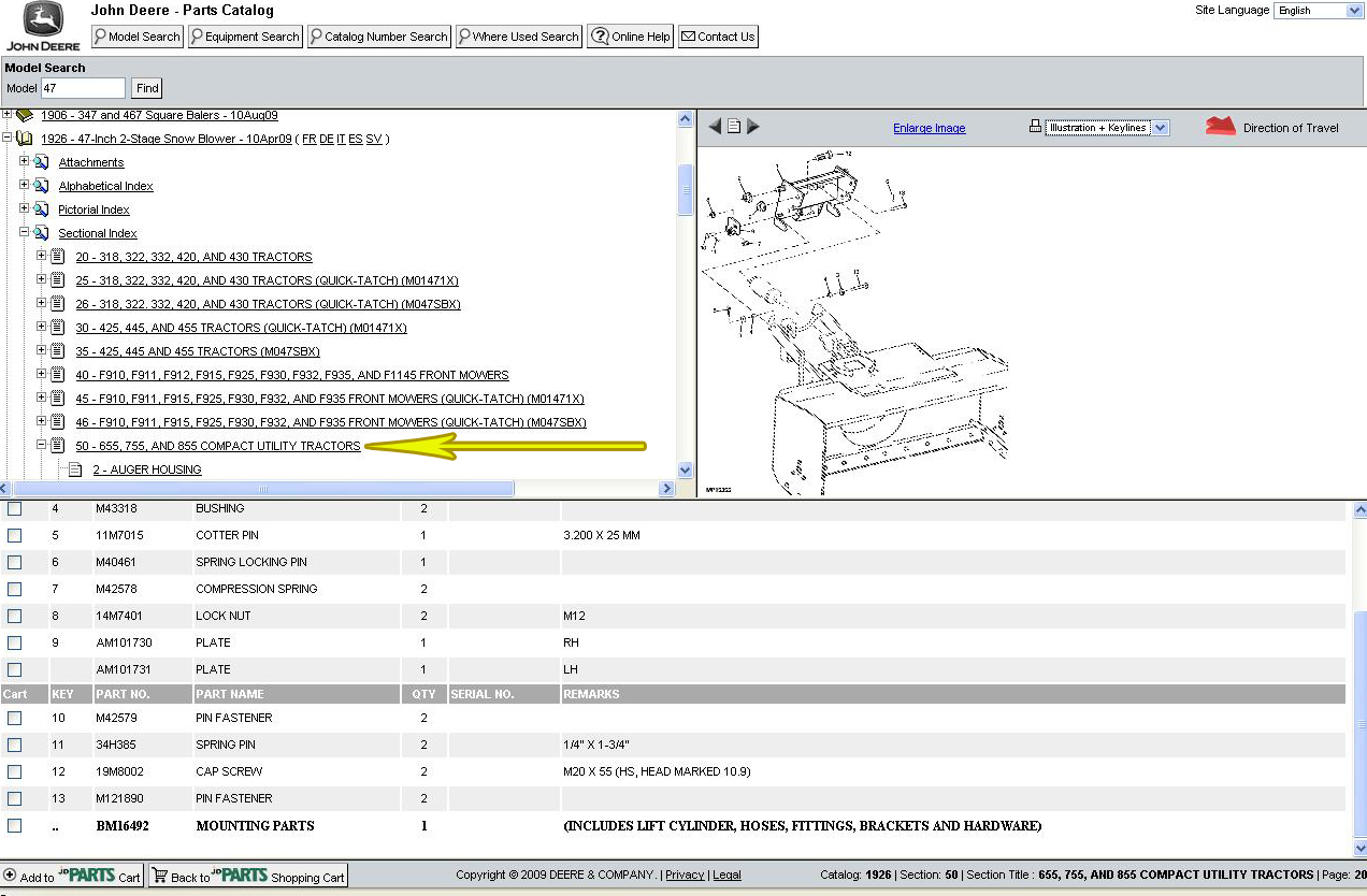

Will a JD model 47 Snowblower fit a JD 855 tractor? ...without welding...
What would I need to install it?
The model 47 currently has a JD 318 mount on it?
Will the 318 mount work on the JD855?

Yes you can fit the 47" blower to your 855 with no welding...
BUT I have no clue about the mounts for the 318 fitting on the 855, but Deere does offer a mounting kit for the 47" blower to fit the 6/7/8/955's

Deere does not offer mounts for 47 inch snowblower.855 is to wide for 47 inch blower.59 inch snowblower has mounts for 855.
   / Snowblower Question? #5
While I agree the 47" is little narrow for an 855....You are wrong about the mounting kit....Deere DOES offer the Mounting kit..
Take a look at Catalog #1926 on JDParts.com...
-Sectional Index
-Section: 50 - 655,755, AND 855 COMPACT UTILITY TRACTORS
If you got it cheap enough you could have some 6" "wings" fabbed up for each side so you end up with a 6' Blower..

Attached a Screenshot...
