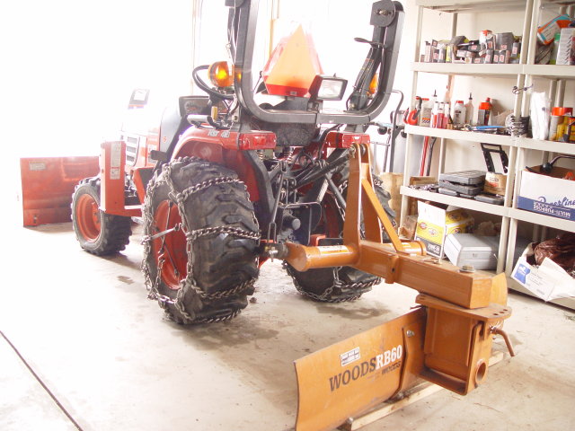

For the past couple of years, I've used a front 5' blower and a rear 5' blade on a paved driveway.
I stuck the rear blade on simply because I had it and the extra weight on the back was helpful. The blade would also clean up the little snow left by the blower; it was also excellent at scraping up tire tracks (compressed snow).
If it only snowed an inch or so of the heavy wet snow, I would just use the blade.
I would also use the blade sometimes to scrape the snow into rows and then use the blower to blow the piles away.
If you have alot of snow in your area, you may find it slowgoing if you only have a blade.
If your choice is a 3pt blower or a blade (but not both), I would say go with the blower.
Note too that the blade will not harm your pavement at all unless the pavement is already otherwise terribly cracked and heaving; I use the blade on it in the summer sometimes to clear the mud off of it after I've moved dirt around (mud in the tire lugs end up on the driveway). You do not need shoes on the blade.
Blade is a Woods - about 270 lbs I think.
