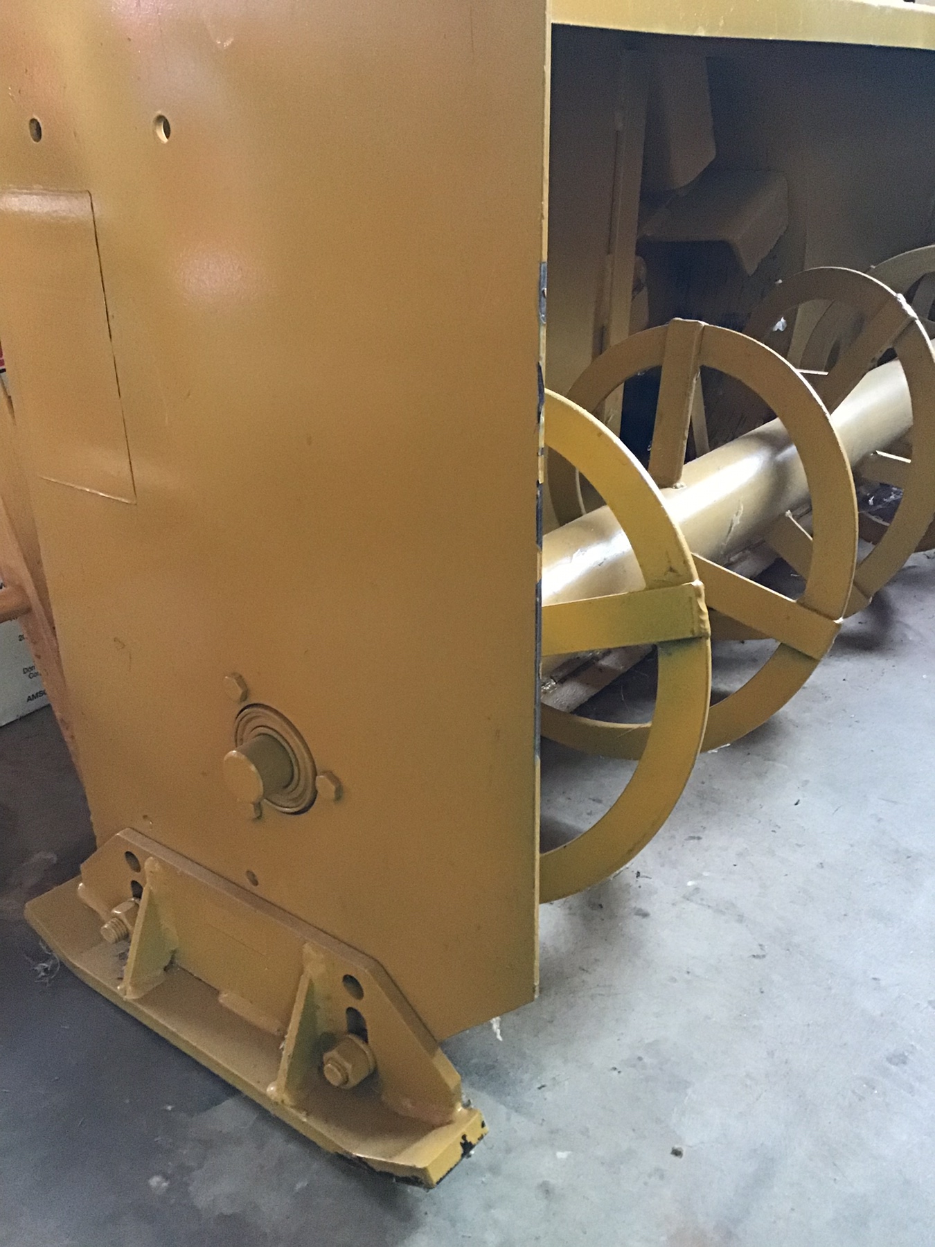

See what RjCorazza has pictured there. When I had a 3-point blower I got a pair of shoes/skids - whatever - directly from the dealer. They were at least twice as wide where they touched the ground and were $56 for the pair. As I remember - - 10" wide by 16" long.
The blower company that I got my unit from is long out of business but with that picture - somebody handy with a welder should have no trouble making up a set.
