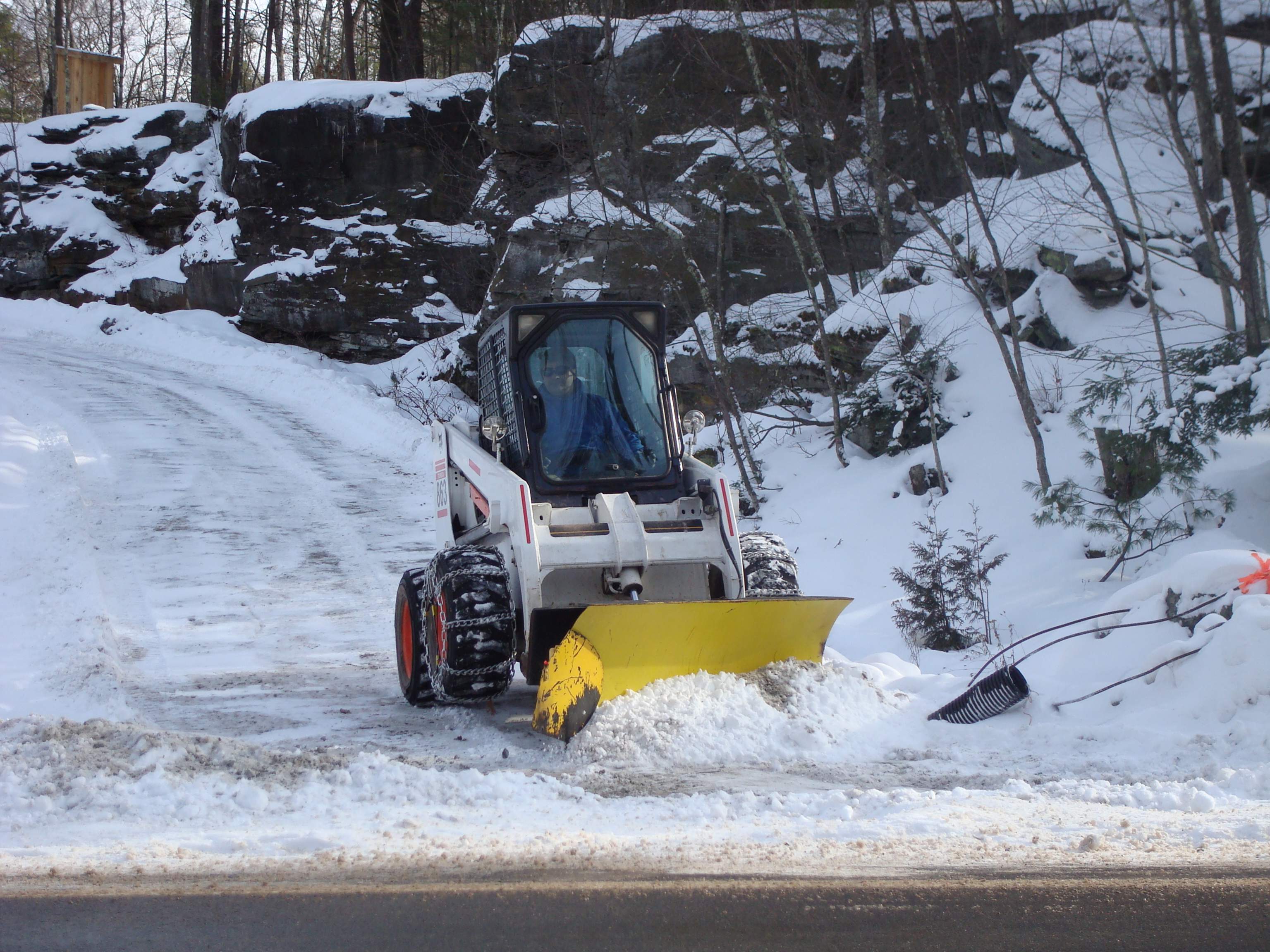

My Bobcat got a plow , i got it from a guy who was in the business to remove snow, he had lots of sidewalks to do , he cut the plow to 5 ft and just had wings installed , I used this year on my driveway and was perfect for whet snow , it's true i have to make 2 extra passes but who cares , it's easy on the machine and the job is done .
In the picture I have only one wing installed .

Razvy,
I wonder if you would be better off with the chains on the rears? When you lift the front with down pressure on the blade, your chains are off the ground.
Just a thought, anyway.

GPintheMitten
You have a point , i was going to do it initially but they was easy to install in the front, I was going to change it to the rear but so far the front works just fine , I usually plow downhill .
