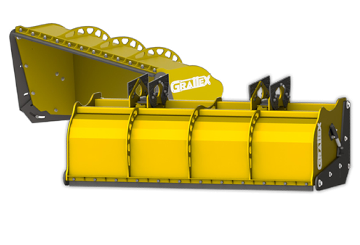

Hi,
Maybe this can sound a strange question, I don't know.
What is the best width for a snow FEL reversible (push or pull) snow plow IN REFERENCE TO THE SNOWBLOWER, for best maneuverability. Is it best to have it a bit wider, same width...??? What are your experience driven opinion on the subject.
I will use this setup for private driveways, (no large parking lot)
(Kioti ck30h with 72" rear SB.)
Thank's

Thank's Deerherd,
My tractor is 60" wide. The plow I intend to use can not by angled. See picture: gratte-rversible.png
Would you then say that it should be 72" like the read SB? My question really is about the width of plow in reference to the rear SB.

That would be a snow pusher, not a plow and a pusher should be sized the same as the blower.
Good luck!
