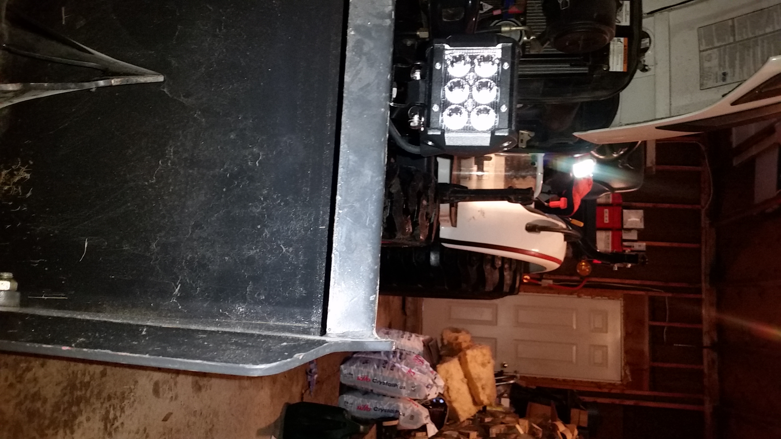

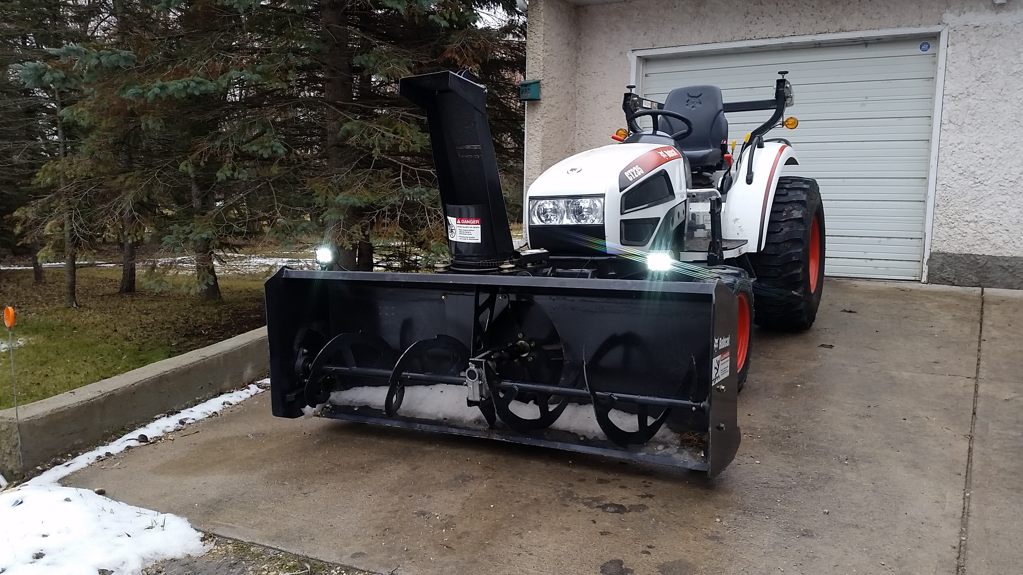

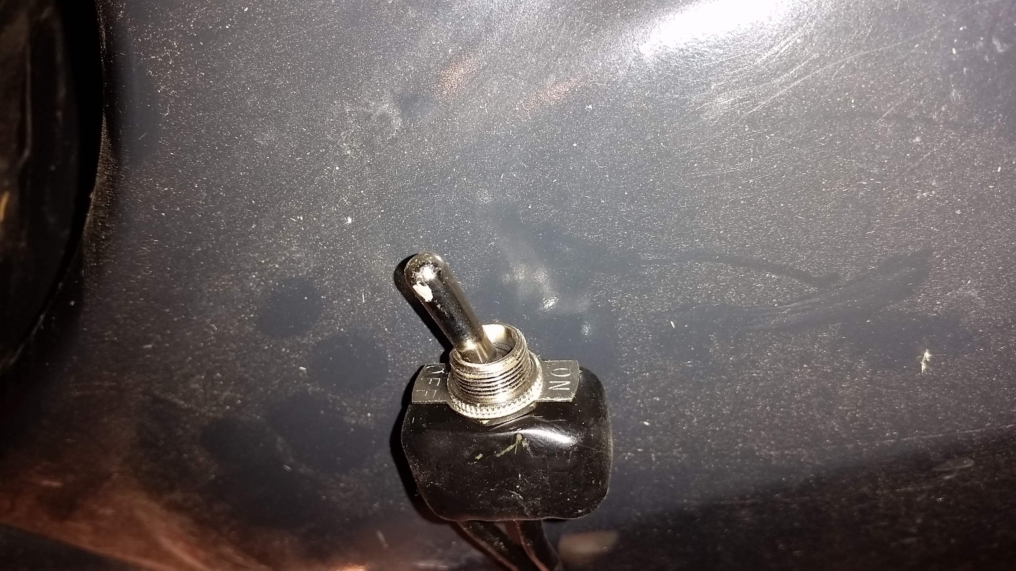

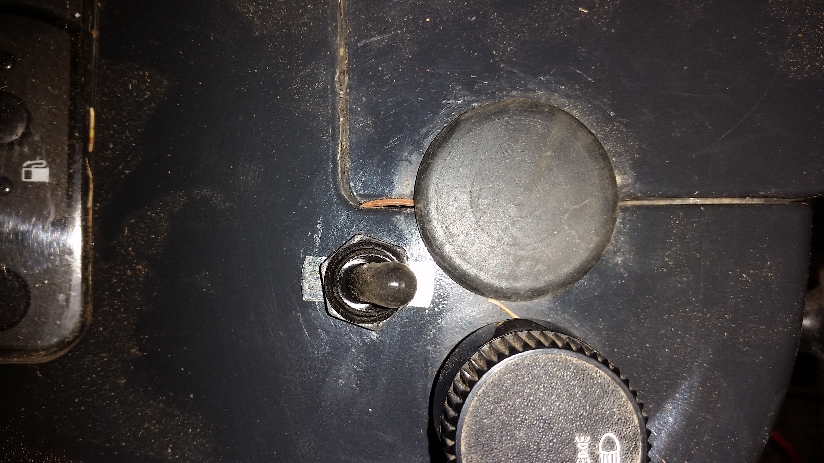

Nighttime snowblowing is always a PITA with standard tractor headlights. My 72" is no exception. I found a pair of 18w LEDs on eBay for cheap. I already had these rubber encased toggle switches, excess from a p BBrevious tractor light install project.
They've got the rubber boot as well and went in the dash easily.

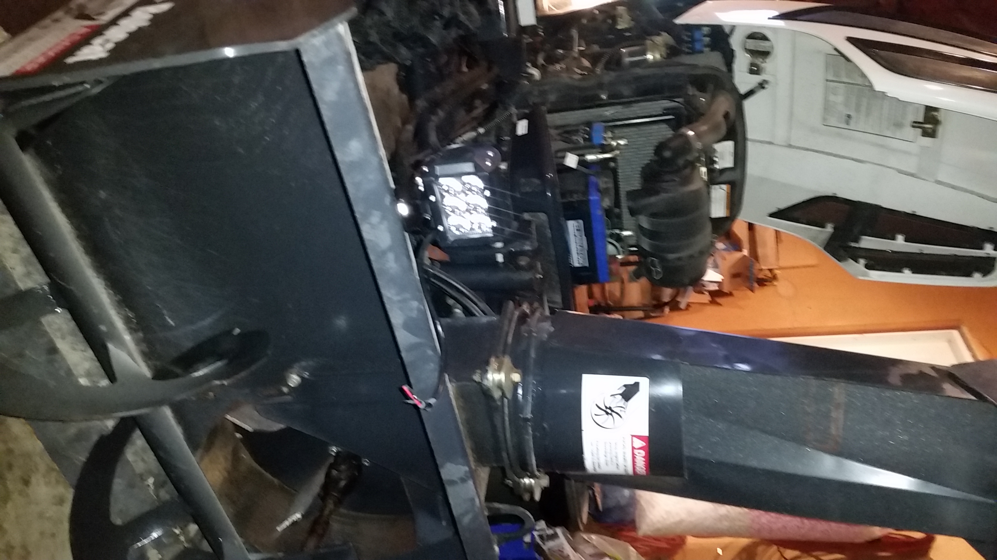

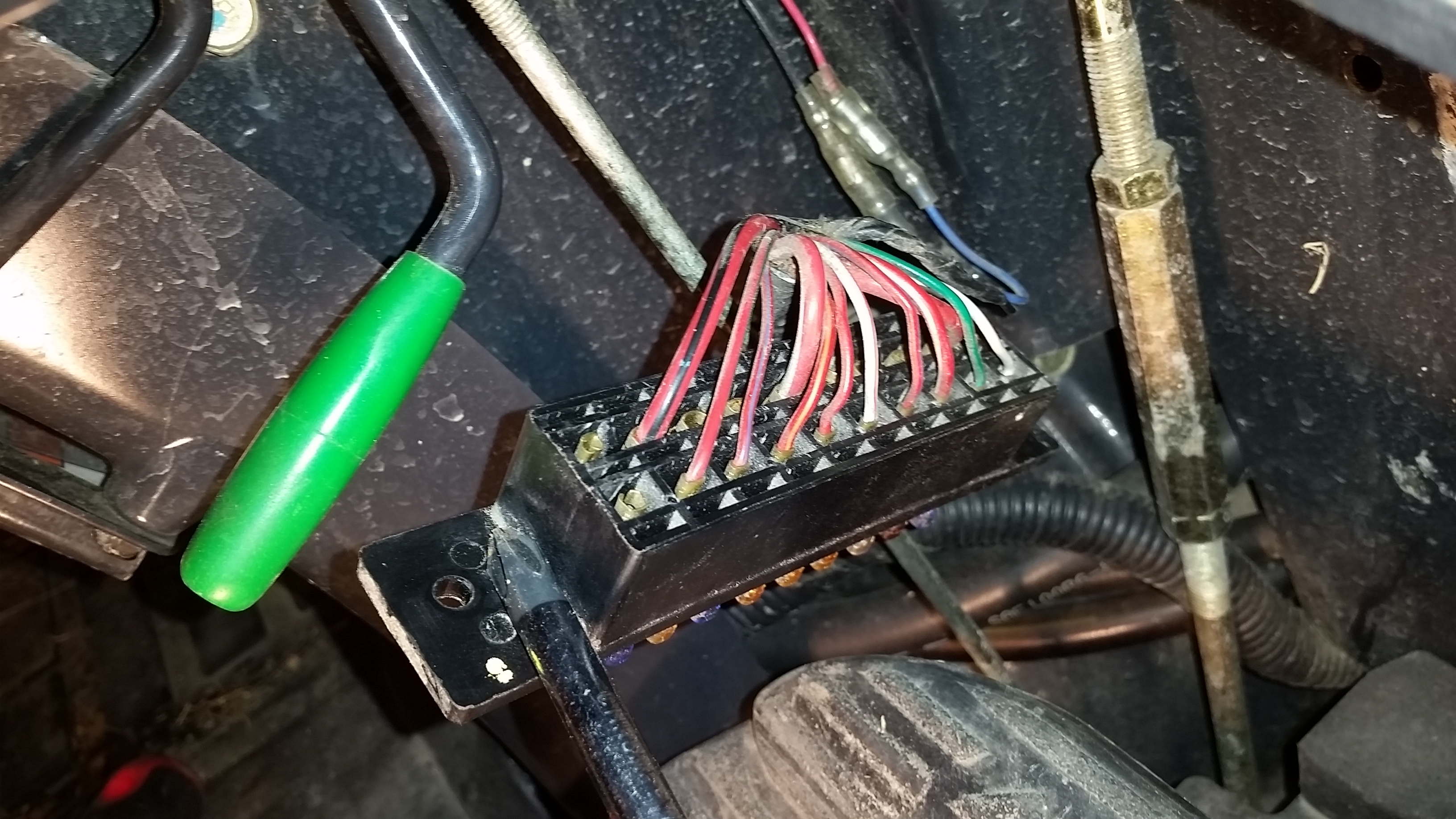

I went through the fuse box's aux accommodation but simply jumped a large wire from a keyed position of the headlight circuit for now. The LEDs are low power consumption and I really just need this done for now. I'm grounding the lights to the snowblower itself and using a bullet connector that'll hide under the bonnet until needed one the season is over.
One for the left
One for the right
Presto
They are small, compact, metal, and cast a big light.
Thanks all!:dance1:
   / Snowblowers lights - 18w LED #2
Looks great! Are you worried they might ice up from the mist created when blowing?
It's too cold here. There's literally no moisture in the air in the midst of winter. It was near -20 yesterday.

I mounted my lights on the ROPS, so the light is up higher shining down. The problem with LED's and snow is the LED makes little heat, so it never melts the snow off the lens.
I used 48W LED's and they are stupid bright!
I like the idea if the lights stay clear!
My ROPS hits the garage. Even on its partial lower setting it hits. I used to have a Kubota BX and old fashioned 6"round incandescents on it. Two forward and two back, on plates JB Weld'd to the ROPS. They were great.
