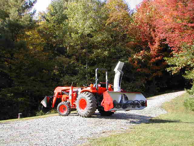

I'm getting ready to purchase a rear-mount snowblower for my 3054. However, I'm having a problem guesstimating the size snowblower that'll work with the tractor's 64" wheelbase and 24 HP PTO. I want to get a 72-75" blower that will fully cover the wheelbase, but checking out snowblower manufacturer's literature, they all seem to recommend 40- 50 PTO HP for an snowblowers in this size range.
I'd appreciate any recommendations relative to snowblower sizes and makes/models that othe Kioti, particularly 3054 users have had success with.

I used a 7' RM last year on my DK35 without any issues.It's a little big for my PTO hp according to most manufactures,but it worked out for me.

MGgrick - Am I seeing things - it looks like the inside of your PTO blower is white with snow - but it is obviously not snow season in the pic ??
   / Snowblowers - LK3054 #5
That's just silver paint!! /forums/images/graemlins/smile.gif
