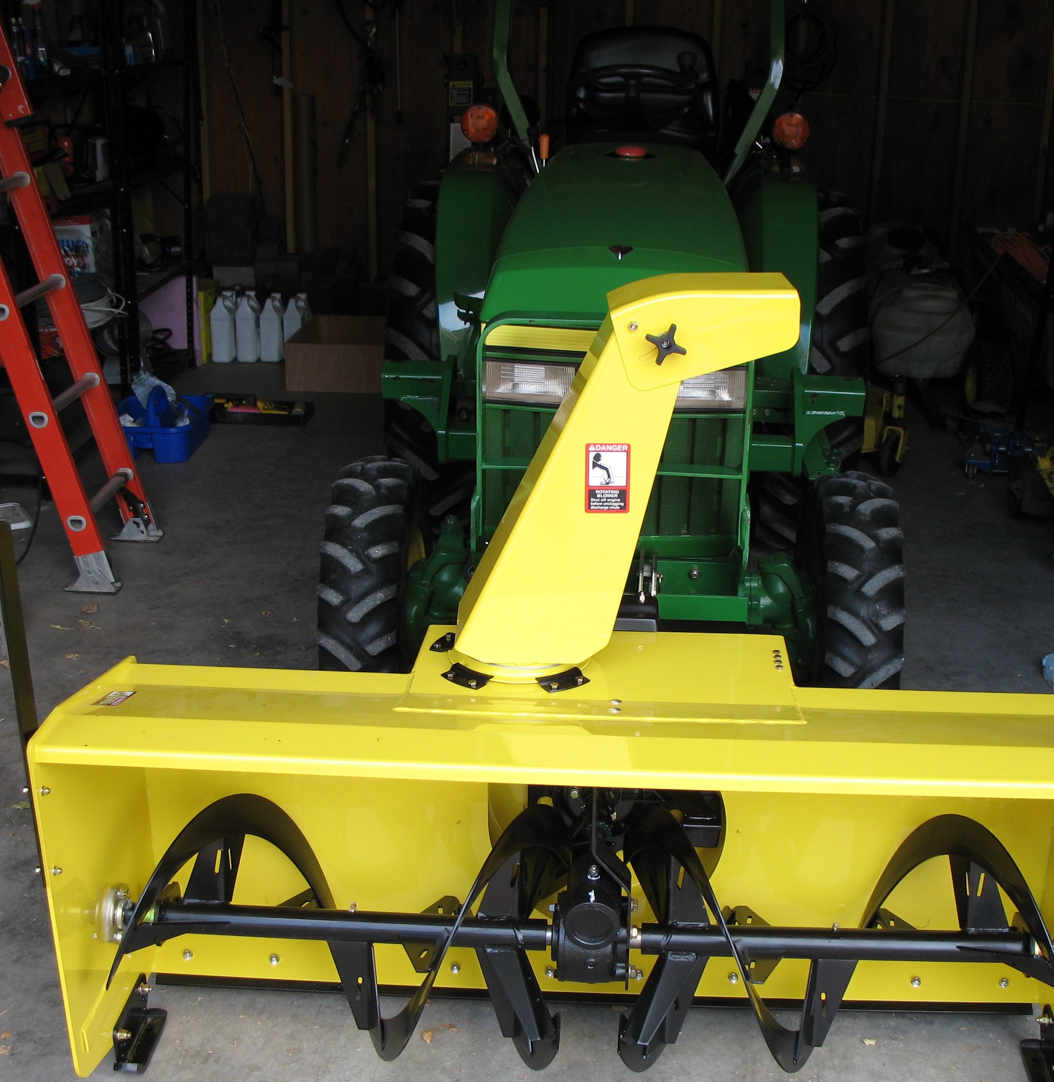

Dave,
Just went through this drill with my JD790 and purchased a new JD59 and required Retro Kits. Here's an on-line tool perhaps you don't know about, John Deere has all the parts and attachments for your tractor listed in their on-line Parts Catalog. Follow this link below and change the model to your tractor, right now its pointing to a 790.
John Deere - Parts Catalog
Next, go to the Sectional Index (again under your model number) and locate the 59inch Snowblower. Go down and look at lines 25, 26, 34 and 40 that indicate they are applicable to Series 35. There you'll see specific Retro-Kit Part Numbers required to attach a JD59 to your tractor. Once you have those in hand then you can visit your JD Dealer for pricing or they are often listed on EBay or even on this site. If you do a search on my userid you'll see I posted pricing for (3) similar kits I used on my 790. The kits and JD59 were very easy to install and I've documented it along the way which I can share, just let me know Good Luck........
