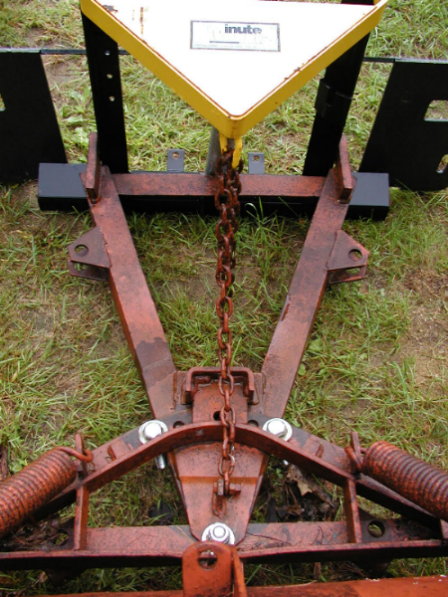

While this thread has nothing to do with tractors per say, the item will atleast be mounted on and pushed by my tractor.
I am slowly getting my snowplow ready for the big chill. some of the modification will include a trip to my local welder where he is going to modify the attaching end so that I can utilize my quick tach system. The attached picture show what it will kinda / sorta look like. Right now the pieces are just leaning against each other, so I could have some idea of the end result. I am going to tell my welder to work the pieces anyway he see's fit, for I am after strength and duribility first and apearance second.

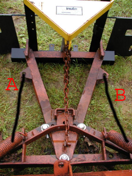

Now from this second piture you can clerly see that I need to install / replace the angling cylinders. Here lies a question. Would these hydraulic cylinders be single acting or double acting ?
I have also found that from some of the diagrams I have run accross, that I am missing the third (center) trip spring so I am going to need to replce that as well. I am not sure just how crucial or necessary this spring is. I have used the plow for the last 2 winters on my old JD and it certainly trips perfectly when it needs to. In fact adding the third spring will, I believe, only make the tripping ability stiffer. I am thinking that maybe it is safer to have the tripping ability less stiff, which means that the blade will/should trip before I may do damage to my tractor.
I am also think of having my welder add a couple of plow shoes, this may help me from digging up my driveway until things freeze.
I am totaly open to suggestion for this project. Any ideas ?

You either need one double acting cylinder or two single acting cylinders to angle the plow.
I'd go with two single acting as the plow frame is likely sized for a standard plow cylinder.
To figure out what size cylinders you need, angle the plow all the way to one side. Then measure the center to center distances where each cylinder goes (one long, one short). This will give you the extended (A) & retracted (B)measurements. It is OK if your replacement cylinder retracts further than your measurement, but you don't want it to extend any further than your measurements.
Skip the extra trip spring, you are right it will make it harder to trip.
Clear as mud eh?
I edited your pic to show the dimensions (A & B). Be sure to measure with the plow angled

Thanks for the picture edit. Your lines are a little off angle, but thats OK. I ws able able to know exactly what measurment your were refering to. They are 17.5 / 27.5
In looking at diagrams of Western plow parts it shows that the angling pistons are part #18. So I am hoping and expecting that all I need to do is order a pair of them plus the pins and some fittings.
