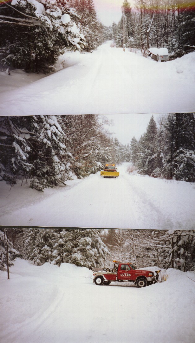

Here are some pics of a road we plow that is about a mile long. The bottm pic is about 3/4 of a mile in. These pics were taken during the New Years Day storm. The truck is a F-350 4x4 dually with a 460 gas automatic. The wrecker body is a Jarr-Dan, with (2) 8000lb winches, extenable winch boom which can be raised to all most vertical, and a 3000lb wheel lift. The plow is a 9FT Fisher. BTW, this is the truck I posted on with the brake trouble. We have plowed this drive 4 times since these pics were taken on New Years Day. We haven't even gotten to our snowiest month yet (March)/w3tcompact/icons/crazy.gif.

Derek great pics. Something I've been wondering is how are the brakes holding up? I could see why you want the Ford straight axle after seeing the fisher hanging off the front. Add a set of Pro wings and you could really cut a wide slot in all that snow.

Rowski,
I can only wish for such a snow fall down here. Just think, no bills for 2 months!!!! /w3tcompact/icons/smile.gif

The brakes seem to be ok. They are not where I would like them. What I did was to adjust the rear brakes up, just before you hear the shoes start to drag and leave it with that. Normaly one wouldn't adjust them that tight but it seems to help. The plow weighs about a 1000lb. and hangs out 4ft from the axle. I have seen the prowings but 9ft blade full of snow and the truck runs out of traction (dual wheels). See attachment for something similar to the prowings. We use this to cut back the side banks, work well for side banks next to ditches. The plow was not designed to handle this wing but being gentle and using it before a thaw it works pretty well. I'm working on similar a setup for the tractor. I'll post pics if I ever get it done /w3tcompact/icons/crazy.gif.

Derek,
Looks like you need a wing attachment before March snows arrives. /w3tcompact/icons/shocked.gif
Ever get caught in a white out while plowing the back roads.
I guess you don't get stuck and pulling out those Humdingers don't look like much of a problem for you.
Great looking setup,and if I had to set 12 plus hours behind the wheel as you have to I to would want to go in style, /w3tcompact/icons/wink.gifand I don't dare to ask how much you have invested w/ that setup /w3tcompact/icons/crazy.gif
Looks like you be out again today plowing your route.
Stay safe and take care over there.
Thomas..NH /w3tcompact/icons/wink.gif
