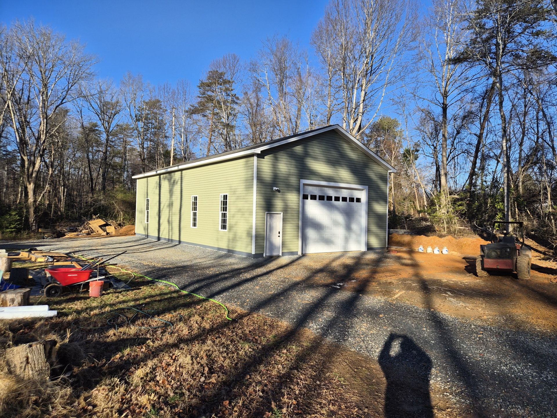

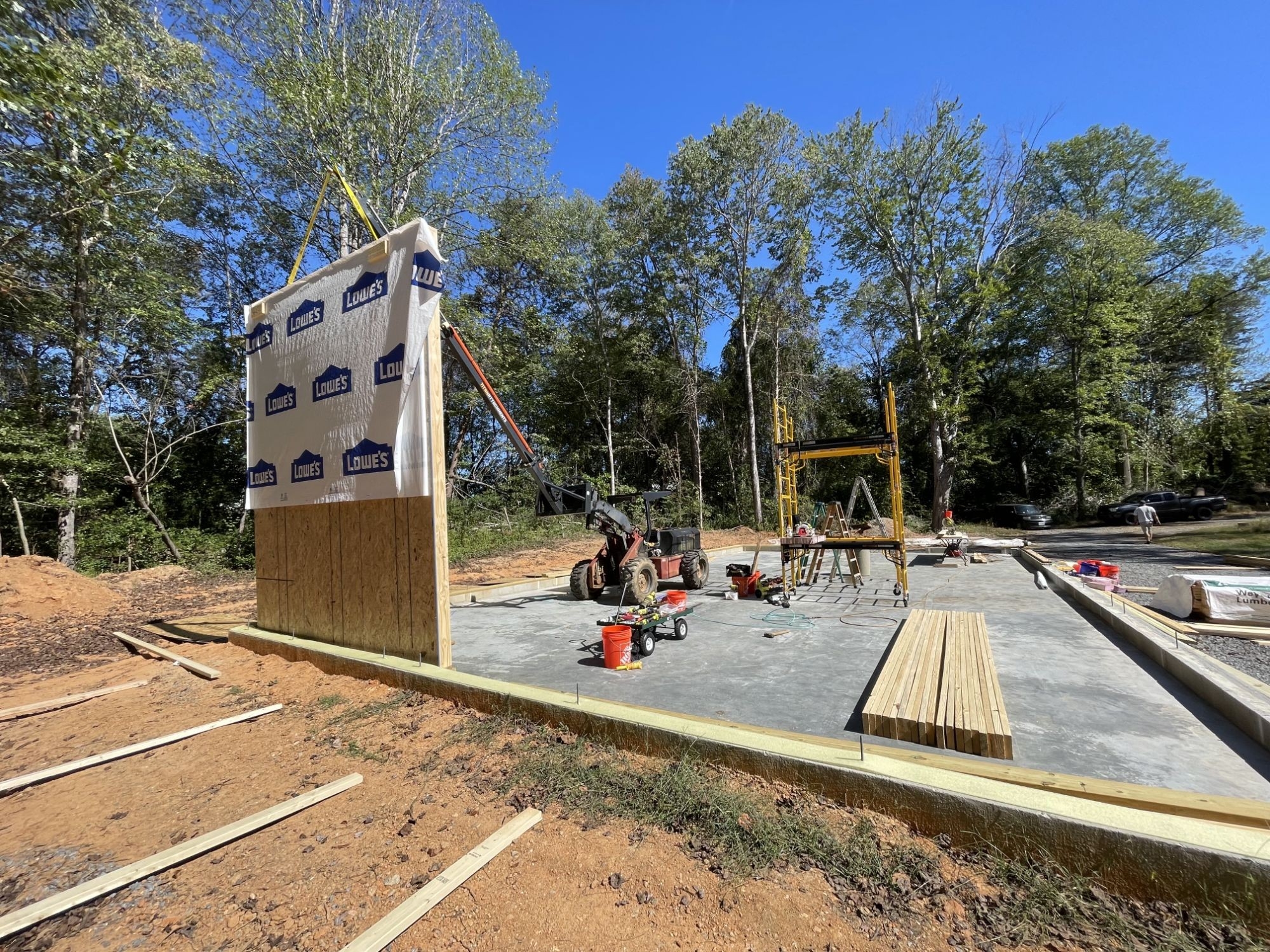

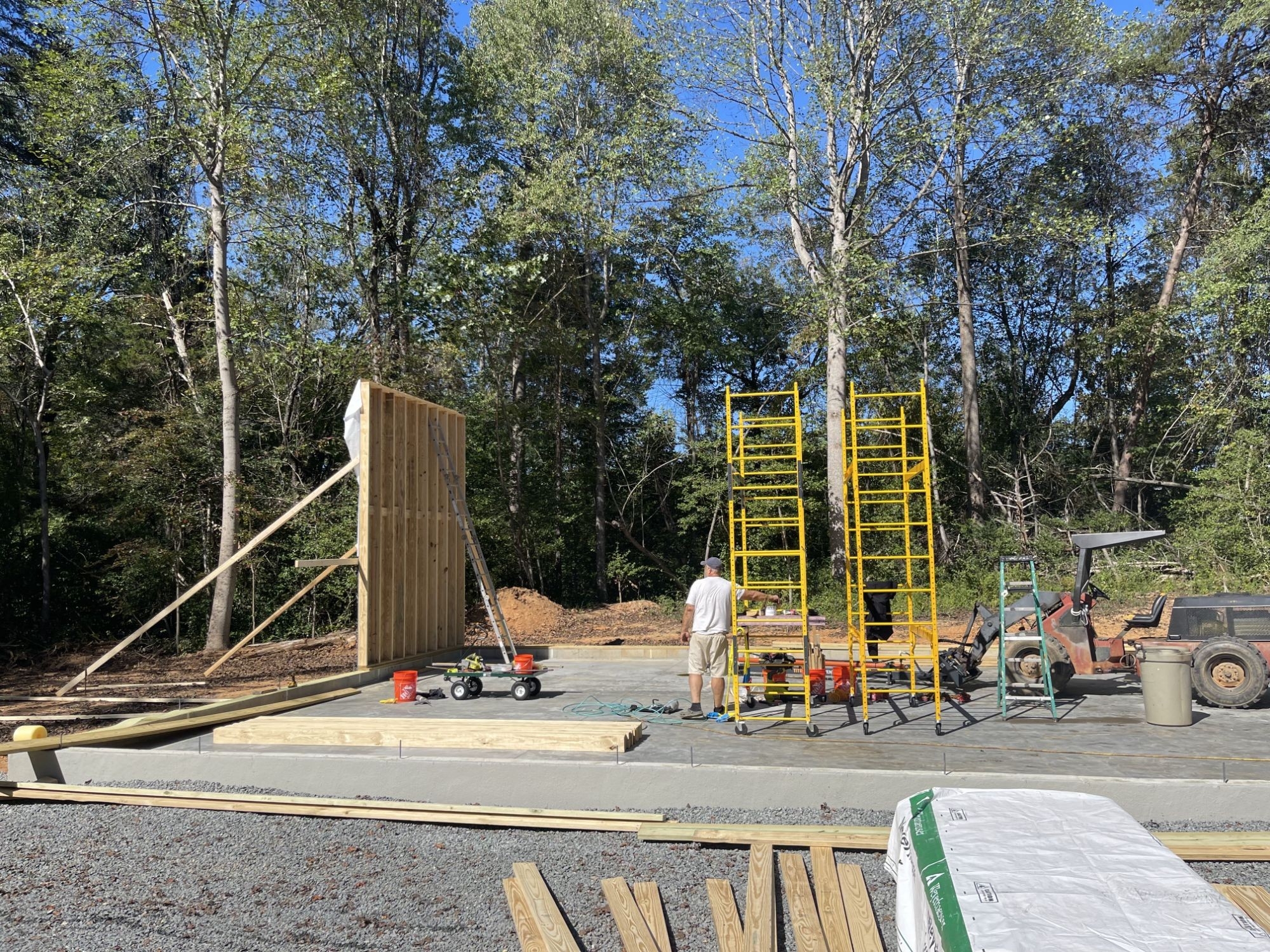

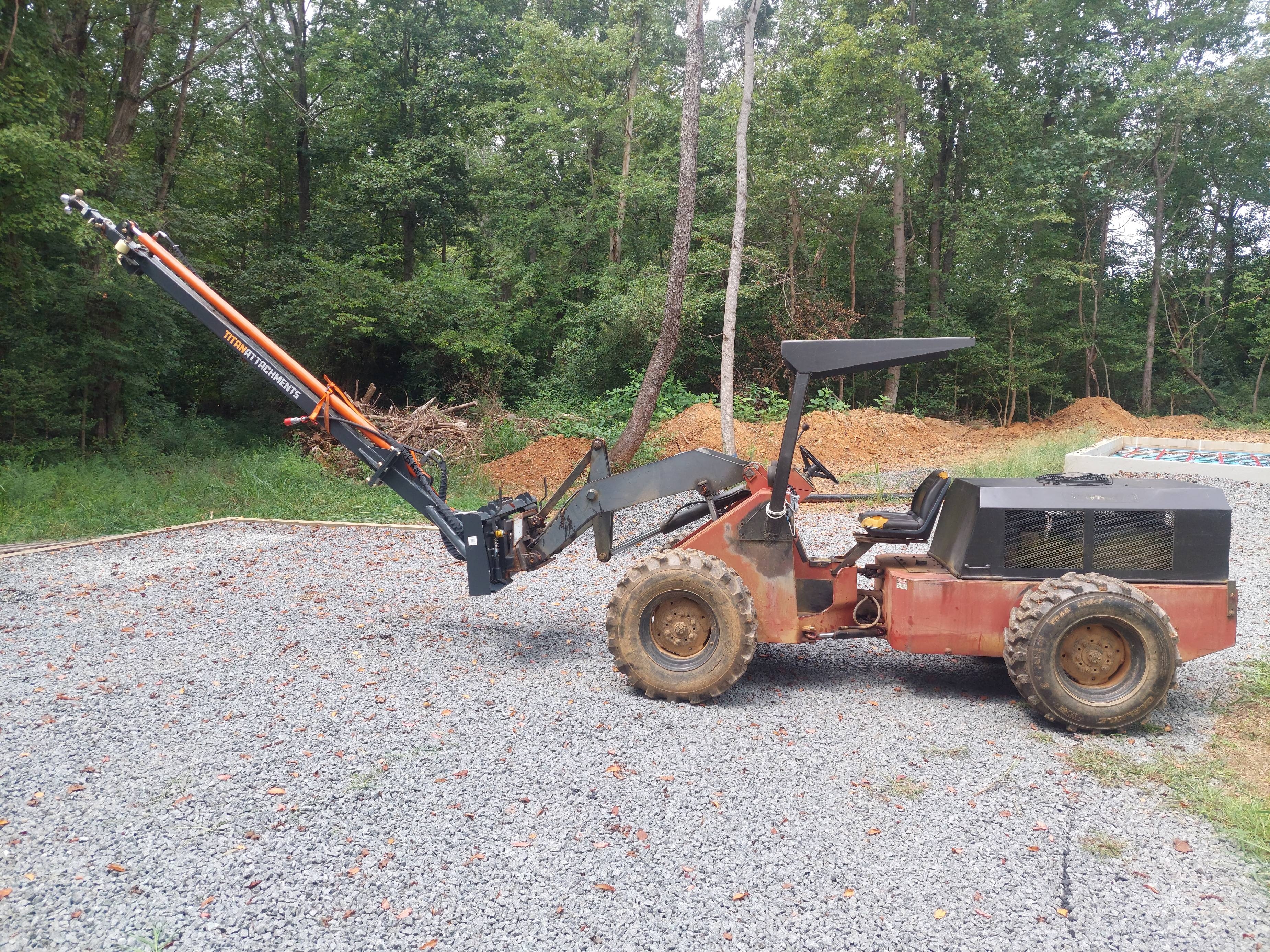

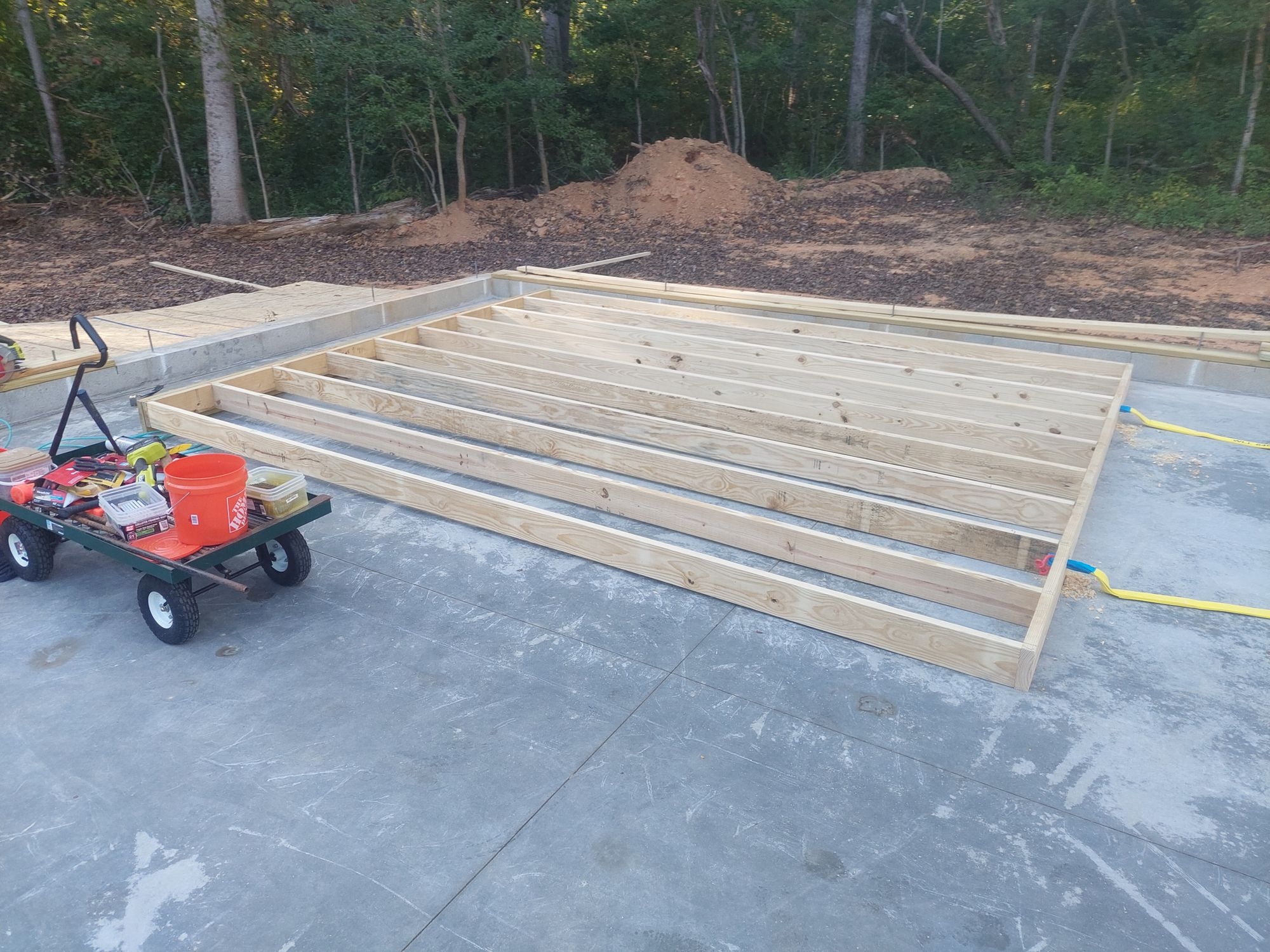

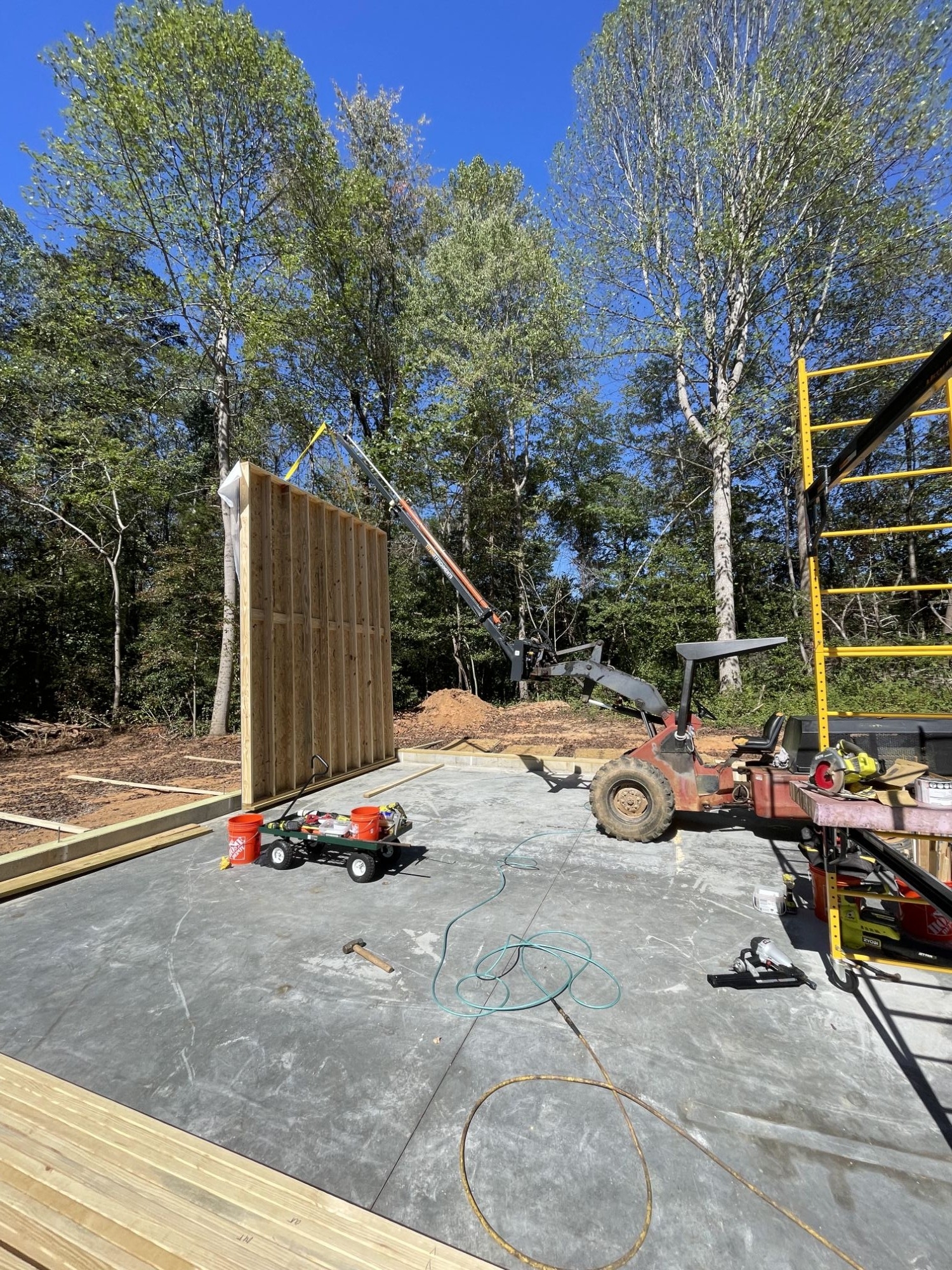

Workign great with my PT to SSQA adapter plate. Going to frame up the walls and trusses for my garage as soon as the concrete is complete.
Getting some very high prices for the garage construction. Can easily do the walls and trusses with this attachment.

How far doe that thing extend!??

When I added our addition to our garage a few years ago, I used the PT425 forks to set the first section of 12'w X 8'h wall. Then I realized it was just easier for my wife and me to tip up each section into place manually. They were 12' x 8' sections up onto 1 course of concrete block. I set the trusses by myself by leaving them upside down, carrying them into the garage, setting one end up on the left wall overhung, setting the other end over the right wall, then swinging them up into place with a pusher 2x4.

The boom pole goes out to about 25 feet. There is a main section, a hydraulic telescoping section and another final section that gets you to the approx. 25 total feet.
My garage is either going to be 12 or 14 foot walls with about another 8 inches of block to the final concrete?
Have not decided the final wall height yet as I am considering a car lift for the inside. My initial plan was 12 foot walls but as I learn more about the car lifts, it seems people are recommending 14ft walls? Concrete scheduled for the the next week, so I have to decide soon.
