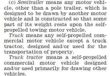

It gets down to the definition of "truck" here is a snipe from 49CFR 390.5
So, if you are not a commercial operation you do not need to stop. However if you look like you could be a commercial operation they may "run you down" to check.
that's about what I was taking it to mean.
I remember once I was pulling my GN with an old ford strapped down.. passed a scale, and a guy passed next to me in a small panel van pulling a landscape trailer full of yard equipment.. no signs or #'s on the truck.. but the trailer did have some lil metal sign on the fold up ramps. we weren't a good 1/4 mile past the weight station when I saw the blue light special coming up fast behind me.. I looked over at my buddy who was riding shotgun and said.. well.. lets see what happens. at the last moment the DOT changed lanes and pulled over the guy hauling the landscape equipment. that weight station was the one that had 7-8 dot in cars lined up on the roadside.. so if they had wanted me.. they could have got me.
