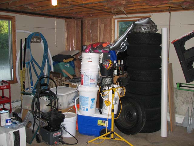

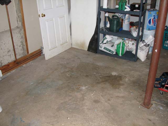

Step 1 - move all the garbage out of the way
Step 2 - MOST IMPORTANT - remove laundry from the basement

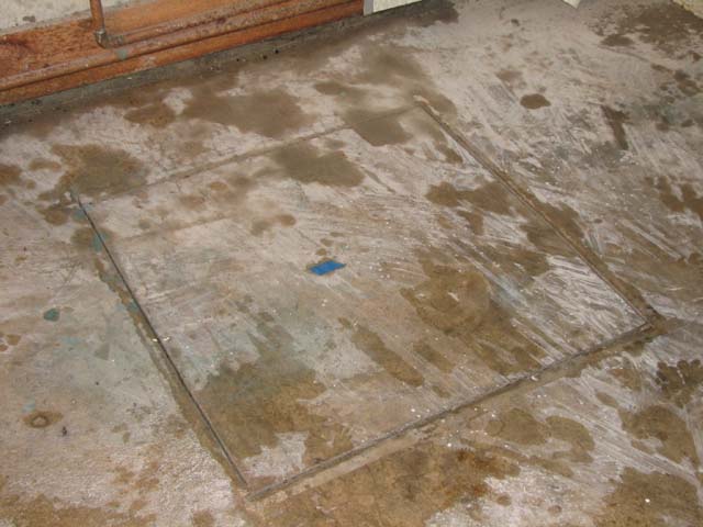

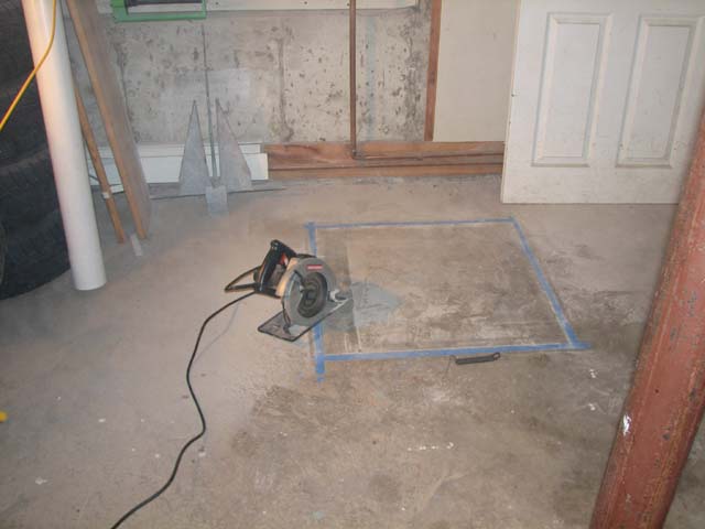

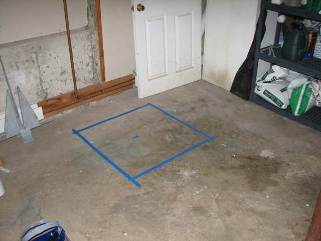

Step 3 - mark it out
Step 4 - score with old circ saw & diamond blade - man does that make dust!
pic 1 junk
pic 2 laundry
pic 3 clear
pic 4 blue tape marks the spot
pic 5 scored cut

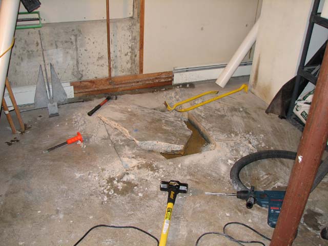

step 5 - fire up the big boy concrete saw
step 6 - cut one side - set off smoke detector
step 7 - frantically vacuum up all the water
step 8 - repeat 6 & 7 3 more times

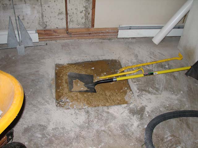

step 9 - chisel out corners

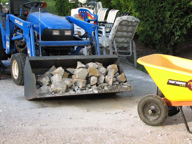

step 10 - wack it with 10lb sledge
step 11 - pry up big piece
step 12 - break it up some
pic 1 saw
pic 2 cut
pic 3 corner
pic 4 big slab
pic 5 done

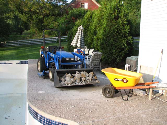

Lastly transfer to tractor for transport.
hole is for new footing required because house was not built to code:mad: Girder in basement (4) 2x10s won't support 1st 2nd & 3rd floor at current 8' span. I need to shorten them up to 5'.:mad: :mad: :mad:
I must say the Makita saw with diamond blade chewed thru the floor like butter.:cool:
