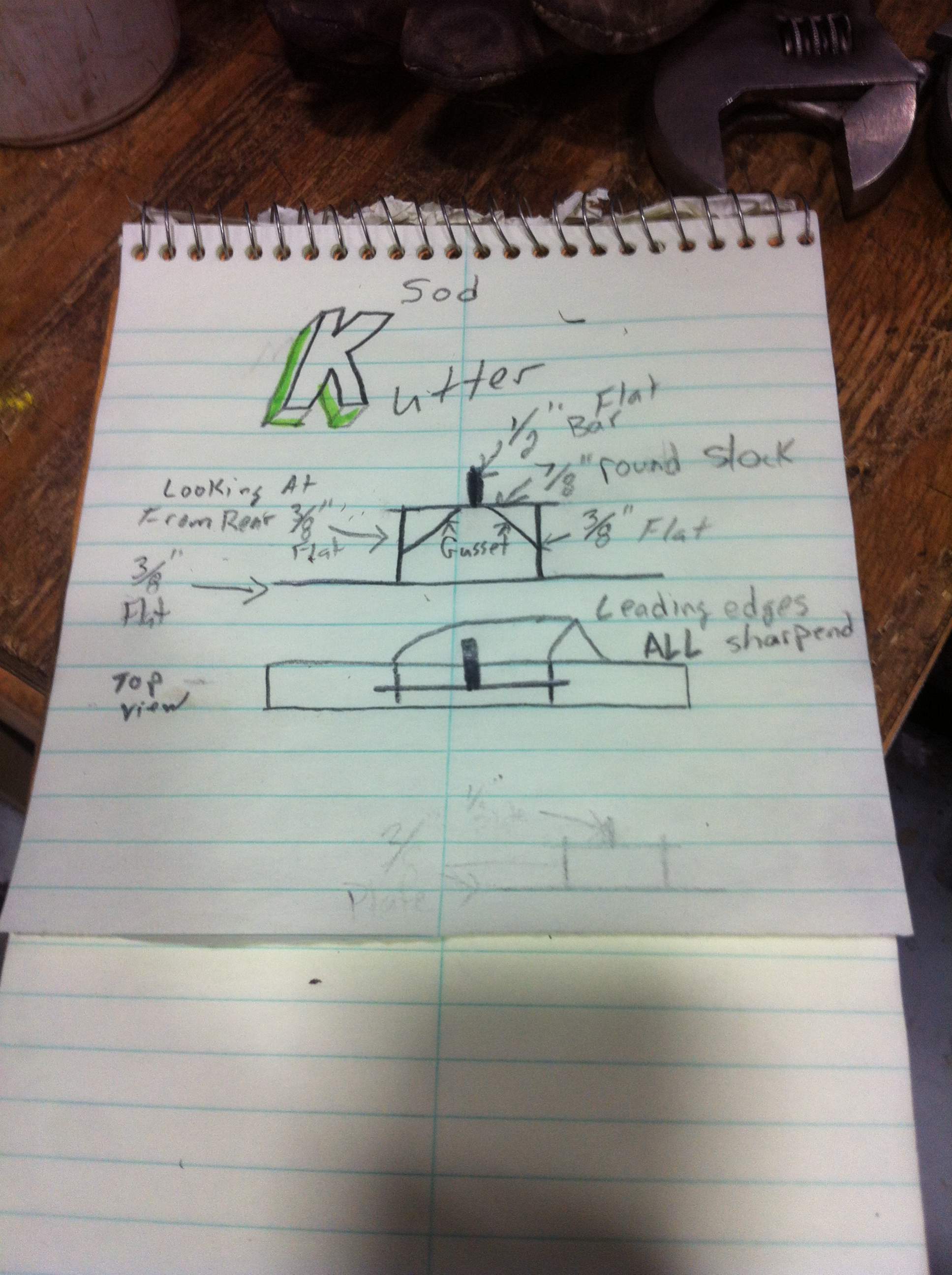

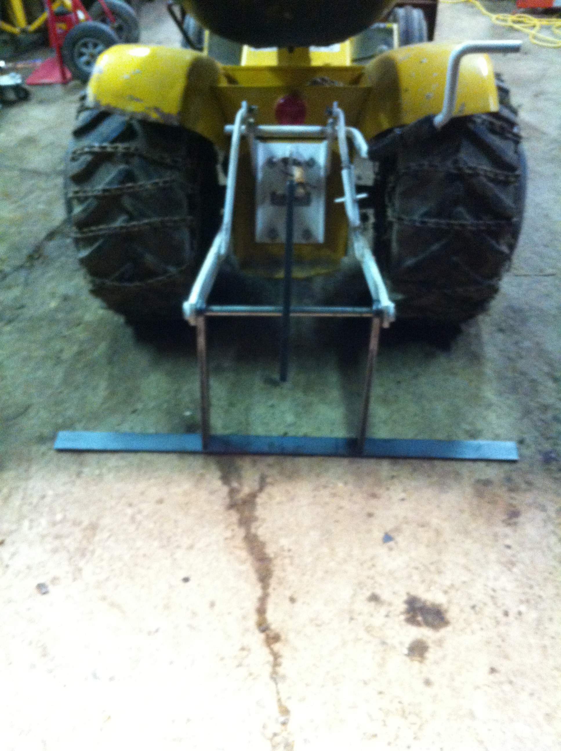

Here is what i am working on. Nothing nearly as heavy duty as yours, but I just need to take the sod off of about 30'x40' for our new garden plot. The top soil is real soft bottoms soil and its still real damp from the thawing snow and the rain.
Here is a pic of my idea mocked up before tack welds are hit
Now this is still a work in progress! I already have two more support brackets in mind.
I kinda had this design in my mind and pieces laid out before i happened on your older site. I will make something of what I have mocked up!

   / sod cutter #5
Hello,
Now with that said, I hope that my Sears ST16 will pull this thing i have rigged up!

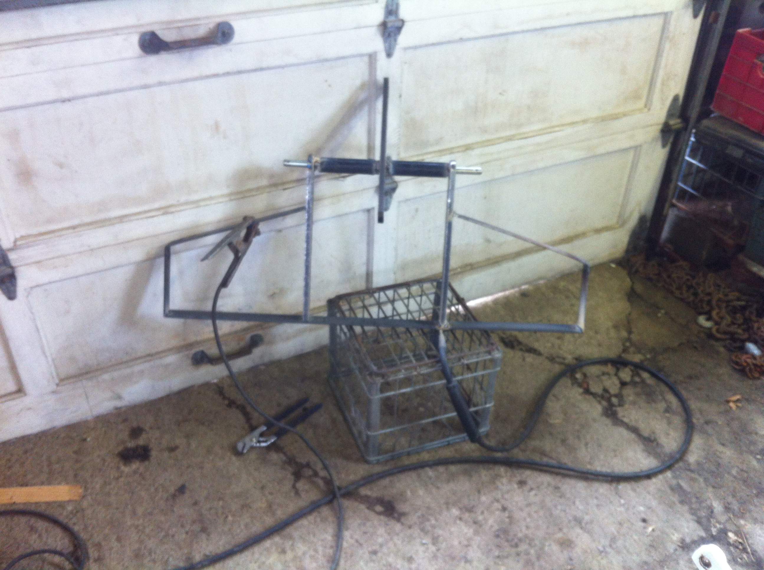

Got it all welded up today

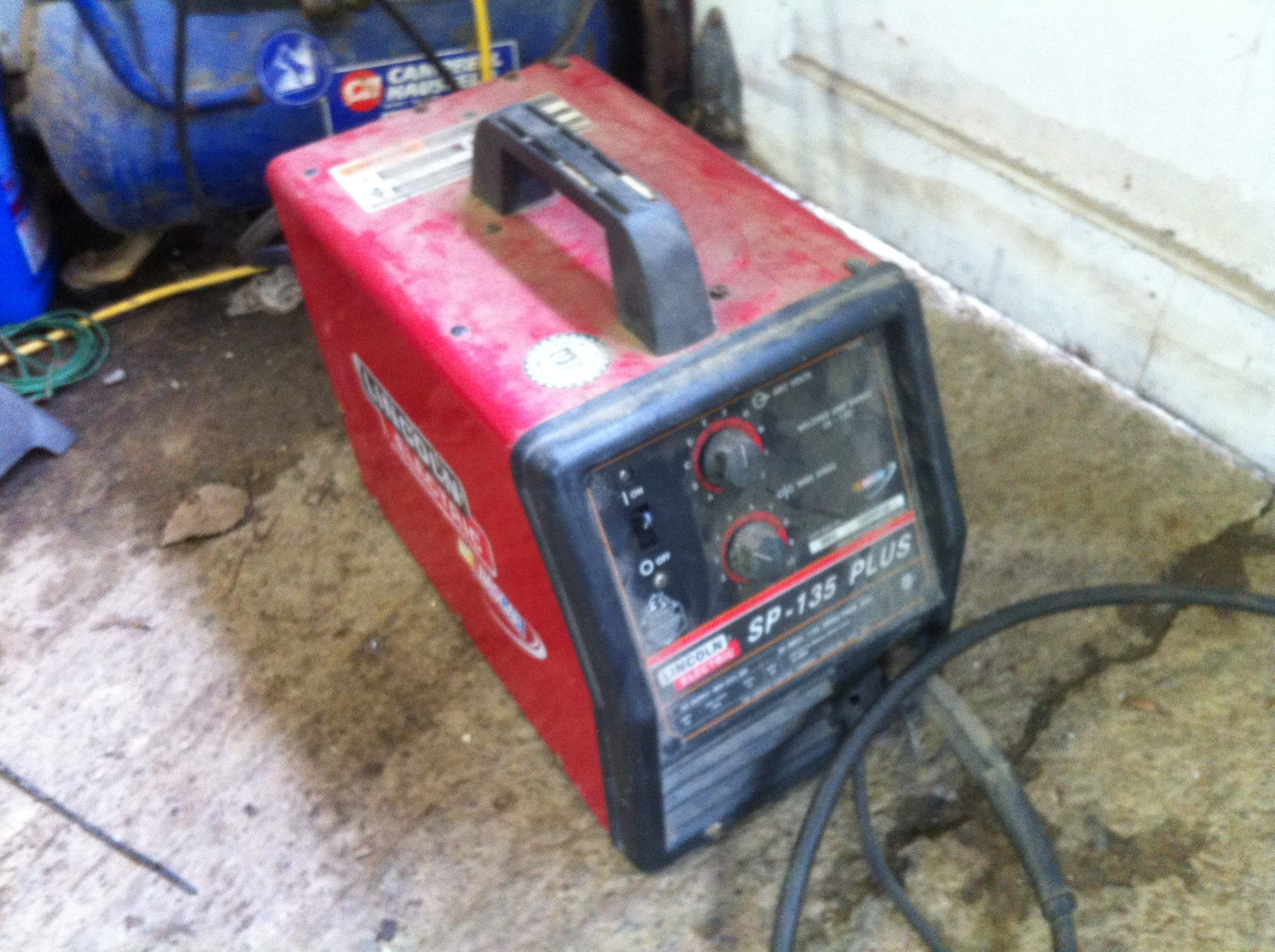

Here is the real hero of this adventure! The mighty Lincoln wire feed!

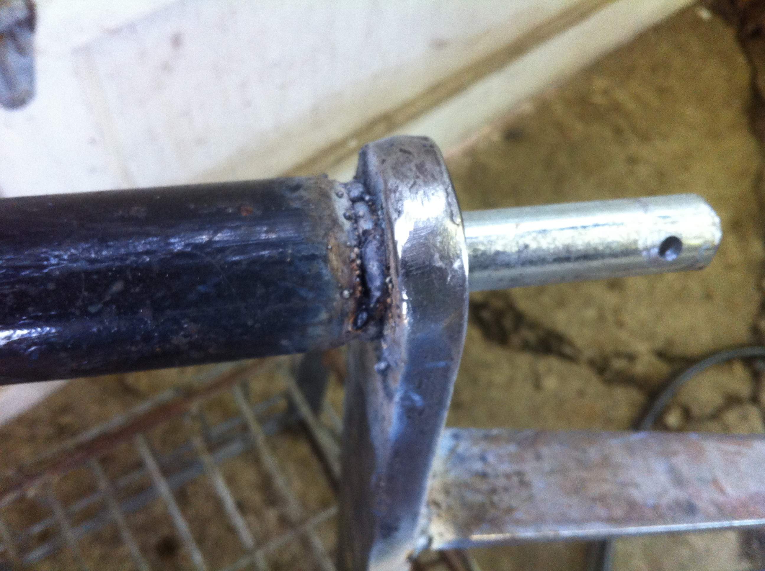

a "root" pass

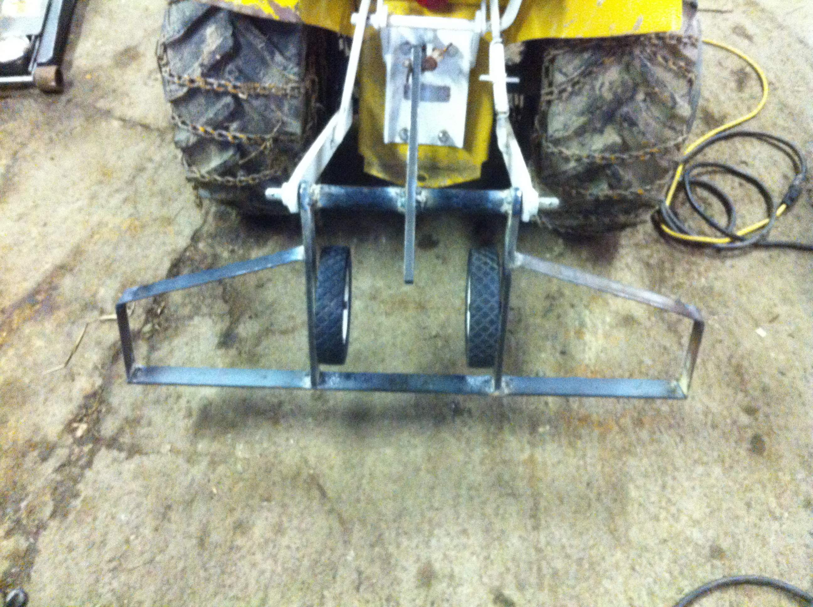

Mocked up on 3 point for further analysis!

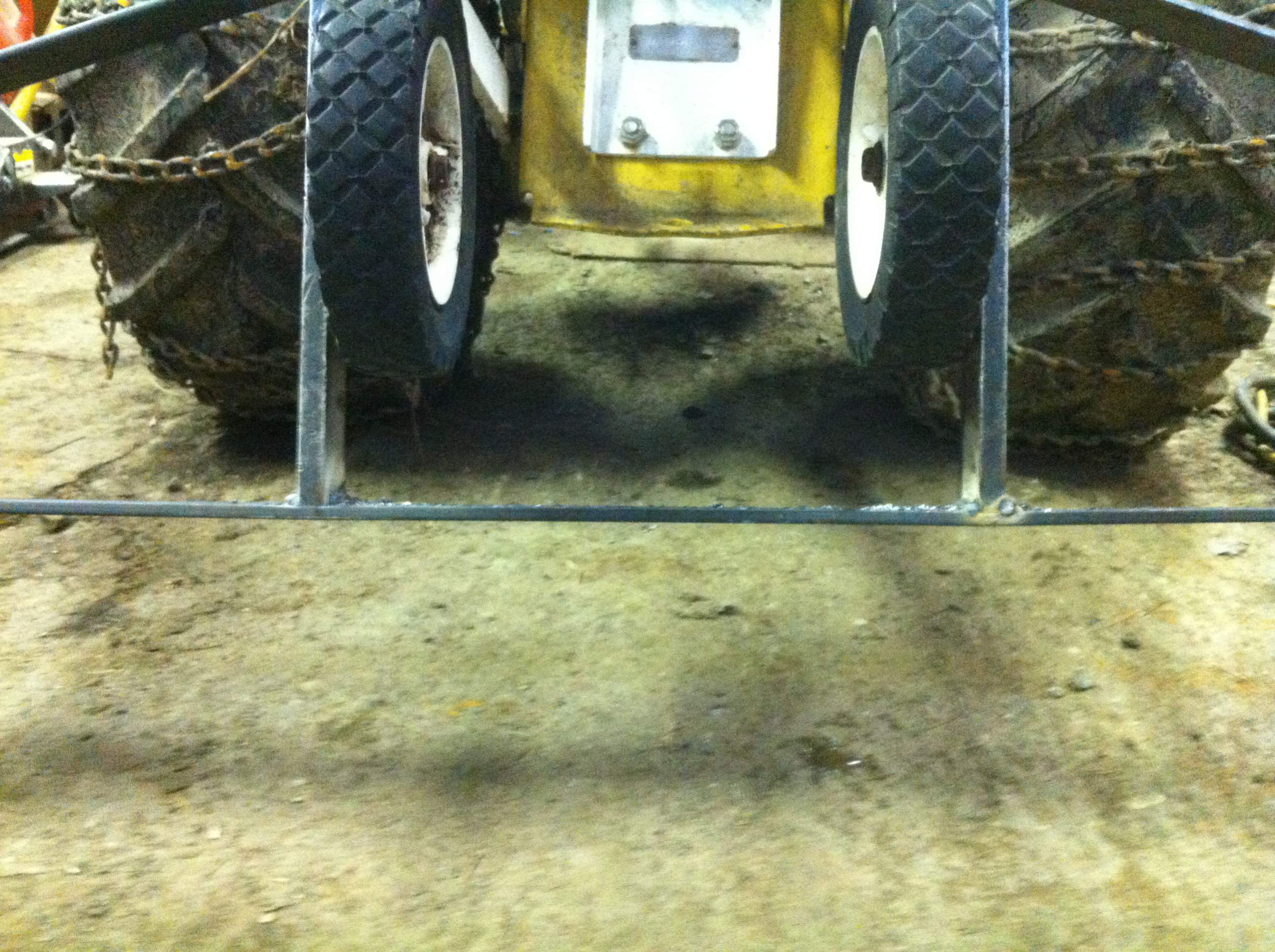

After I got it welded up, & mounted to 3 point, I decided to put some gauge wheels on to prevent the cutting edge from going to deep?
they should allow a depth of about 2 1/2', if my calculations are correct!?
Tomorrow I plan to pull some sumac stumps out, then in that area I hope to put the SodKutter through its test run! Maybe I can get my daughter to shoot a video of the fiasco!!
   / sod cutter
That looks like 1/4" flat stock. Have you ground a sharp edge on all of the leading edges that will contact the sod? In wet sod it will tend to rip the sod instead of cutting it. How are you keeping weight on it to keep it in the ground? It sure looks good from here. Looking forward to seeing the video.
   / sod cutter #7
Chain Bender,
Yes 1/4" flat stock, yes sharpened leading edges that contact sod,down pressure exerted by me via the manual lift 3 point hitch on my Sears ST16, get video out as soon as i can. Think weight on it rather than may be a good idea! tried it today, failed miserably!it started out good got under the sod and cut, but then the tractor lost traction, when i raised 3 point to regain traction the cutter got on top and lost the cutting effect!
oH WELL back to the drawing board! your design looking good !!!
