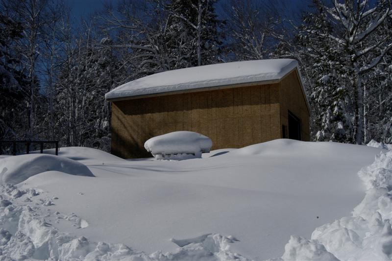

My tractor its for weeks at a time 150 miles from home in a garage with a great eastern exposure. I've seen ads on Harbor Freight and Northern Tool for solar panels that put out low wattage power. Has anyone used one of these to build a battery tender to keep a battery charged?
I would appreciate any opinions or ideas on this subject.

My tractor its for weeks at a time 150 miles from home in a garage with a great eastern exposure.......
Wouldnt southern exposure give you more useable hours of sunshine on the panel (s) ?????
It seems to me- eastern exposure would only provide sunrise to mid morning charge on the panel(s)- at best.

We use solar power to charge the storage batteries on our RR signal locations and the guys have to go out and pull the snow off of them on occasion. If you are away from your area very long your panels may become ineffective. They work great in the none winter months and we're talking about some big batteries.

The best thing to do with snow is put the panels in a strictly vertical position so that they don't accumulate any snow. Direct light, and incident light from the snow are more than enought to generate charging current. I have two 15 watt panels keeping my fencer feisty all year round.
CAUTION: Unless it says otherwise, a solar panel should not be connected directly to a battery. I will discharge at night, and overcharge during the day. Make sure that you do or don't need a charge controller with whatever panel you buy.
