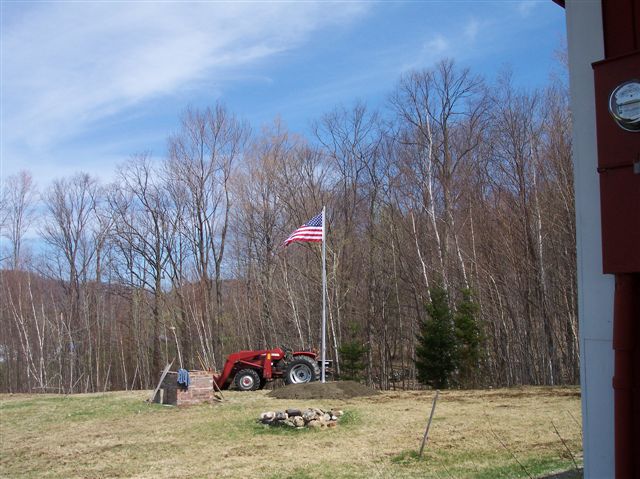

Mornin Bones,
Thats just what the Doctor ordered ! ;) I put a flag pole up on my Vt property last year and Im only there on the weekends, so shhh I leave the flag up all night with no light ! :( I hope Im not in too much trouble for stating that, I do realize that is NOT proper flag etiquitte ! That light may be the answer ! Thanks !
