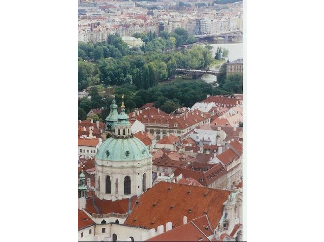

Here is Mikulas (St.Nikolas) church in Prague with copper roof, always liked the look of that.2598095-Kostel_Svaty_Mikulas_Prague.jpg

one of the cities I work in does some brass and copper roof's looks nice..
